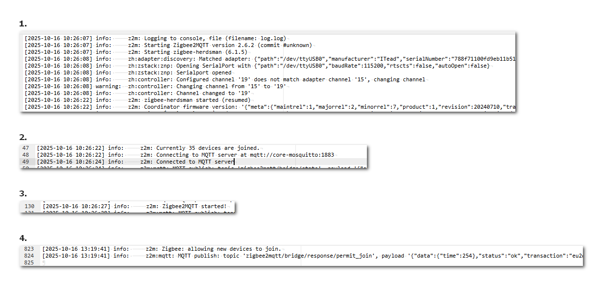

My Zigbee2mqtt can’t add new devices. I’ve already used ChatGPT to look for the cause but found nothing. Existing devices still work fine and can be controlled through Home Assistant — it’s just that I can’t add new ones. I even tried removing an existing device and adding it back, but that didn’t work either. The Zigbee2mqtt log doesn’t show anything unusual. I don’t know where to start or how to fully resolve this

I also changed the channel, but it didn’t work either

My home network has one Sonoff-P as the coordinator and two Sonoffs-E as routers. I don’t think the limit is the issue
What firmware is your dongle-P running ?
I’m using version coordinator_20240710
