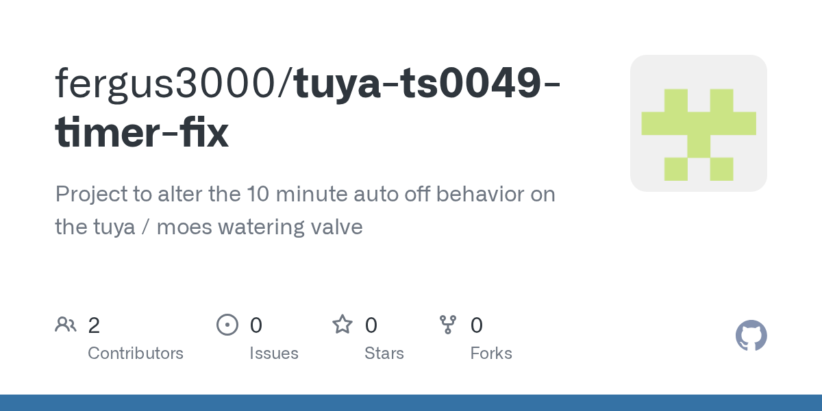

Alright - I have a little progress and some success. Now I can re-configure the timed off setting using a linux pc and a standard conbee controller.
Firstly, I tried again with a new chatgpt context, but still ended up going in circles with the chat telling me to do things, none of which worked. Since I am out of my depth I decided to use this as a case to try out claude code terminal. I had a spare conbee 3 controller, and an old laptop with a clean linux install, I plugged in the controller, installed claude code, and after quickly getting bored with pressing enter to let it take its next step, decided to put it into ‘dangerously-skip-permissions’ mode. This was really fun, I just occasionally made a comment or suggestion and let it get on with it, while I played Civilization on my other pc and occasionally listened to the valve clicking :sunglasses:
So after a while it seemed to get a handle on the problem, and figured out how to use a combination of deCONZ and zigpy to use some python scripts to configure my valve. I have successfully managed to set my timed off on my valve to 3 hrs. The entire write up and scripts are here - so this should be repeatable without using any AI helpers.
I have done this on my rack of 5 valves, and the 3 hr timer works great, even after I re-paired them with my z2m in home assistant. Now I am gonna get them out in my garden and start watering.
