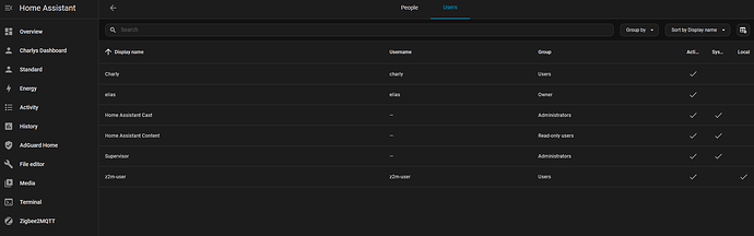

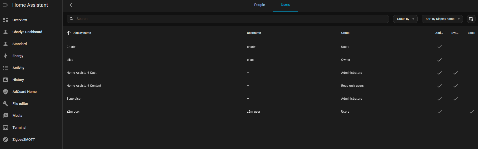

Did I mess up my initial MQTT login configuration maybe? I followed a youtube tutorial - unfortunately I’m not allowed to post the link as it is the third in this post…
I created a user (MQTT-user, as in the tutorial, now renamed to z2m-user) in home assistant:
