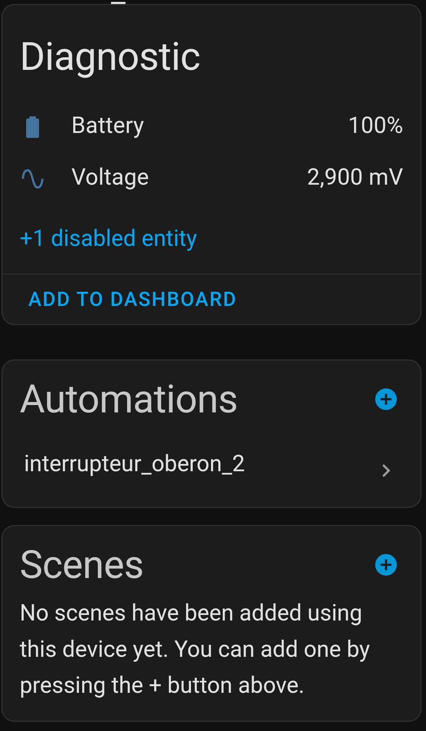

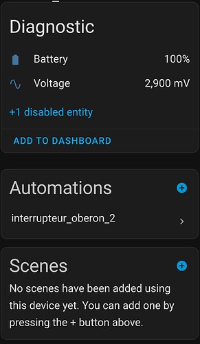

Go to Settings → Devices & Services → MQTT → Your Switch. What do you see (drag a screen shot into the post).
Hadn’t tried that route. Here’s what I see:
Can’t see any difference from the two other same model switches.
