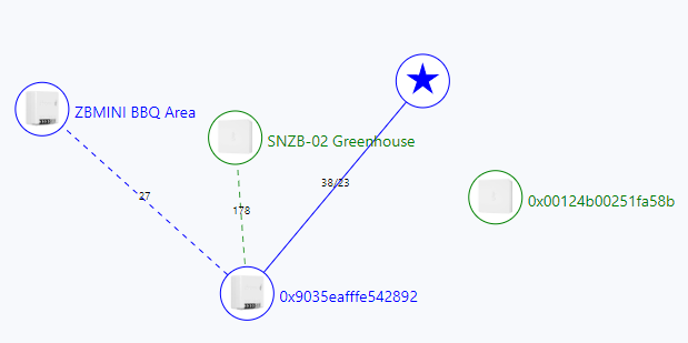

I’ve connected another Sonff ZBMINI to my small zigbee network to extend the range a bit. This appears to work fine and reports status, etc. What I’m finding is that I cannot enroll new devices via this unit and I need to be near the coordinator to do so. Once I move the device away from the coordinator, closer to the ZBMINI it is dropping off the network.
Is there something I’m failing to account for with the configuration?
Screenshot 2022-04-01 082019
Regards,
Paul
What is the 0x00124b00251fa58b device? I and others (if you search the forums here and at zigbee2mqtt) have found some odd behavior between Sonoff, Xiaomi devices and others (mostly around routing). Not exactly the same setup as yours, however, I have a Sonoff (eWeLink) TH01 temp/humidity device that has never shown a connection to the coordinator (direct or otherwise) since day one, yet it sends reading just fine. Go figure.
Hey David,
That device is a Sonoff (eWeLink) TH01 surprisingly enough. It will work direct to the coordinator however.
