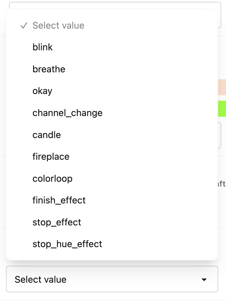

The Z2M UI, has a function that allows light bulb effects to be triggered irrespective of the state of the bulb:
For example if the "okay" effect is triggered, the bulb briefly turns Green, then returns to its previous state.
Is this functionality exposed anywhere in HA?
Such that:
  • If a light is off the bulb briefly turns on (for the green flash) then turns off again.
  • If the light is on the bulb flashes green - then returns to its previous settings?
I am aware of the "effect" setting under "Light Turn On", however that doesn't return the light to the off state.

Yep, can confirm that works. My Effect entity was disabled, which is why I didn't know about it.
You can call the same effect from the Dev Tools multiple times in a row & the light will turn back off.

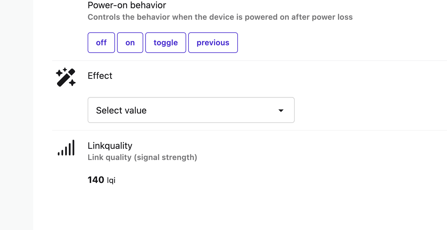

You can also call it from the device page once & the light will turn back off. Annoyingly, the select on the device page stays on the last selection. There's no none option, so you can't call the same effect twice in a row, even if you refresh the page & clear cache.
Looks like calls via the dev tools are the only way to go for now.
I tested the call via a script and it was repeatable, unless I'm misunderstanding
Script is repeatable as many times as you want in Dev tools or scriptws. It's only the Frontend which has issues.
  • On the device page, you have an effect select entity. If you pick an effect, you can only call it once per effect - you cannot call the same effect twice in a row. Light will go back off when the effect is done, which is what David wanted.
  • If you add a card to the dashboard, you can call the effect multiple times in a row, but the light will stay on.
So what I'm saying is that basically service calls are working fine, but so far both Frontend options result in unwanted behaviour.

Accepted this answer, because it had the critical detail that the effect entities are disabled by default.
However once enabled, selecting from any script will work - dev tools are not required.
Also confirming that the light returns to off state after the effect finishes.
