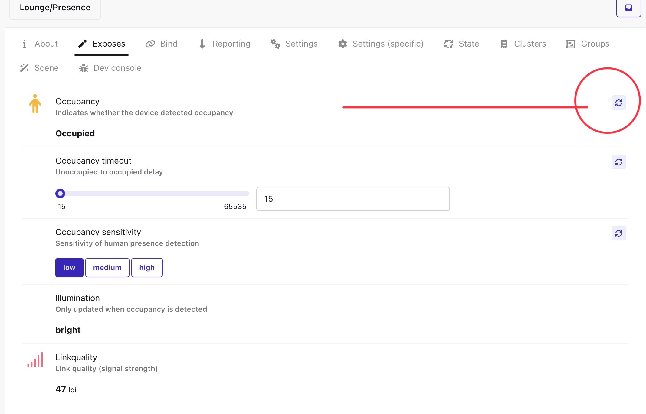

Does anyone know how to replicate the refresh button in zigbee2MQTT in a Home Assistant automation or Mqtt command?
An Mqtt xxxx/get or xxxx/action do not successfully wake up the mains powered device.
But, every time I press the highlighted button it springs back into life.
It is a consistent issue with the sonoff presence sensors, 99% work great then just go into a sleep state every day or so.
It has the latest fw, Home Assistant is on most up to date 2025.12
Would love to automate the refresh option
I have asked this before but I did not get a response that works so trying again.
Thanks
I think I have figured it out
A xxxx/get with a payload of occupancy seems to be working…
