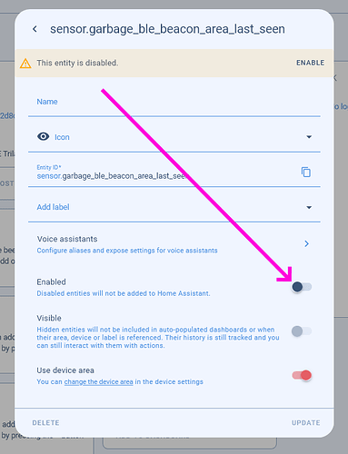

If you mean like this:
Click on that to expand the list:
Click on one of the disabled entities, then click on the cog icon in the pop-up card:
Enable the entity by turning on the toggle switch and then click UPDATE
30 seconds or so later your entity should be enabled.
