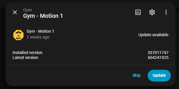

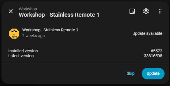

I'm using Zigbee2mqtt and it's constantly talking about devices it wants to update, but it never can.
This is a constant annoyance for me because I keep seeing it. I always press Skip because Update doesn't do anything. The devices work properly but updating does nothing.
Does anyone know how to get rid of these messages?
The easiest way to get rid of them is to do the update. Look up the device update process for those devices. Many battery devices need you to keep them awake by pressing the buttons for them to pay attention long enough to start the OTA process.

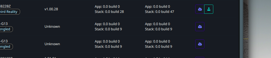

In the z2m OTA section you can force a device to reinstall an update, as well as see the status and timing of the update as it happens. Perhaps give that a try?
So spotted this green thing in there on it. I'll see if it will clear it.
