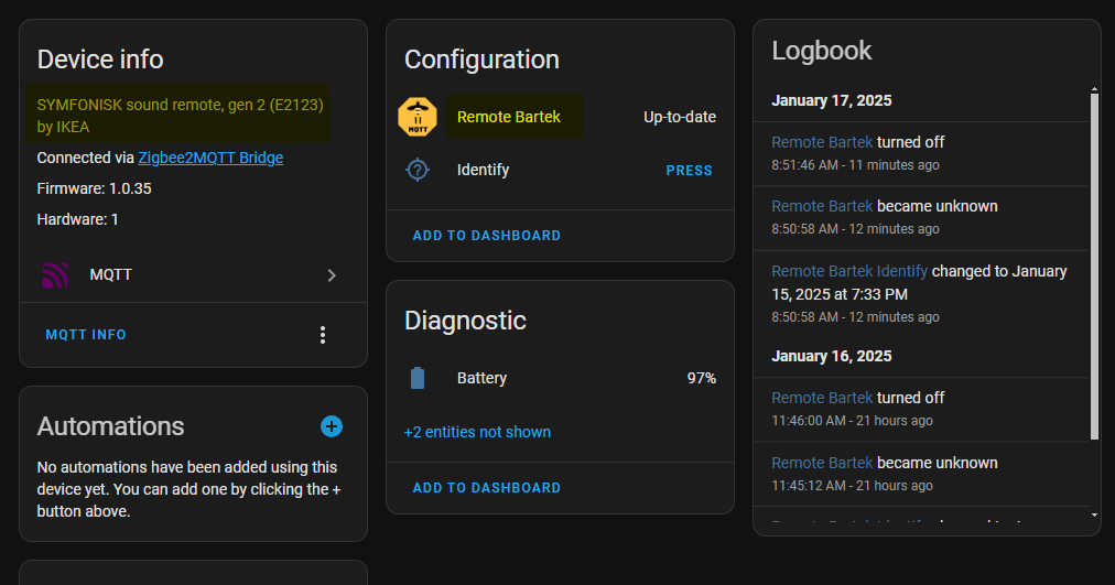

Thanks @Rudinhoo , @BRTK I wonder if it’s a language thing? Could you let me know exactly what you named your controllers and anything relevant to your setup please?
Are you using the group settings/options in Z2M at all?
Any detail you can think of that might be helpful, please share so I can try and replicate. The manufacturer and product code should be enough to show your devices in the blueprint so there must be something else we need to find.
Hey!
Yep, guess we are both on German. My device is named “Symfonisk Remote Bad”. But even without renaming I didn’t see the device in the blueprint. I run Home Assistant Green, everything is up to date.
So far I only have 4 other devices in Z2M (Aqara), no issues.
I’m not sure what else could be relevant.
I changed the HA language + Z2M language but still no luck.
this is the device name and friendly name
But for me it was the same as for @Rudinhoo it didnt matter if i change the friendly name or not the device was not showing in the blueprint.
Zigbee2mqtt Version: 2.0.0-2
Not using the group settings in Z2M
The remote is directly connected to the coordinator / Sonoff Stick
Latest HA Version
and i’m also not sure what else informations I could provide you
@Rudinhoo @BRTK
Thanks both, I think that’s probably all you could provide but I can try a few things using the names you’ve used. I can’t think of a reason why they don’t show at the moment so just need to try a few things.
Z2M groups was certainly an issue for others in the past but can be ruled out based on your feedback.
Leave it with me, I’ll come back to you as soon as I can.
** EDIT ** Having gone back to the beginning on my own setup it seems something has broken or been changed in HA that stops the remotes showing up. If I go to established usages of the Blueprint it is happy to list the remote that was originally selected.
Will be looking into it later
@Rudinhoo, @BRTK
Please re-import the Blueprint I’ve resolved the problem.
It seems Z2M has changed the description of the remote to drop “(E2123)” as well as the earlier addition of a comma.
It should all work ok now but please let me know :smiley:
