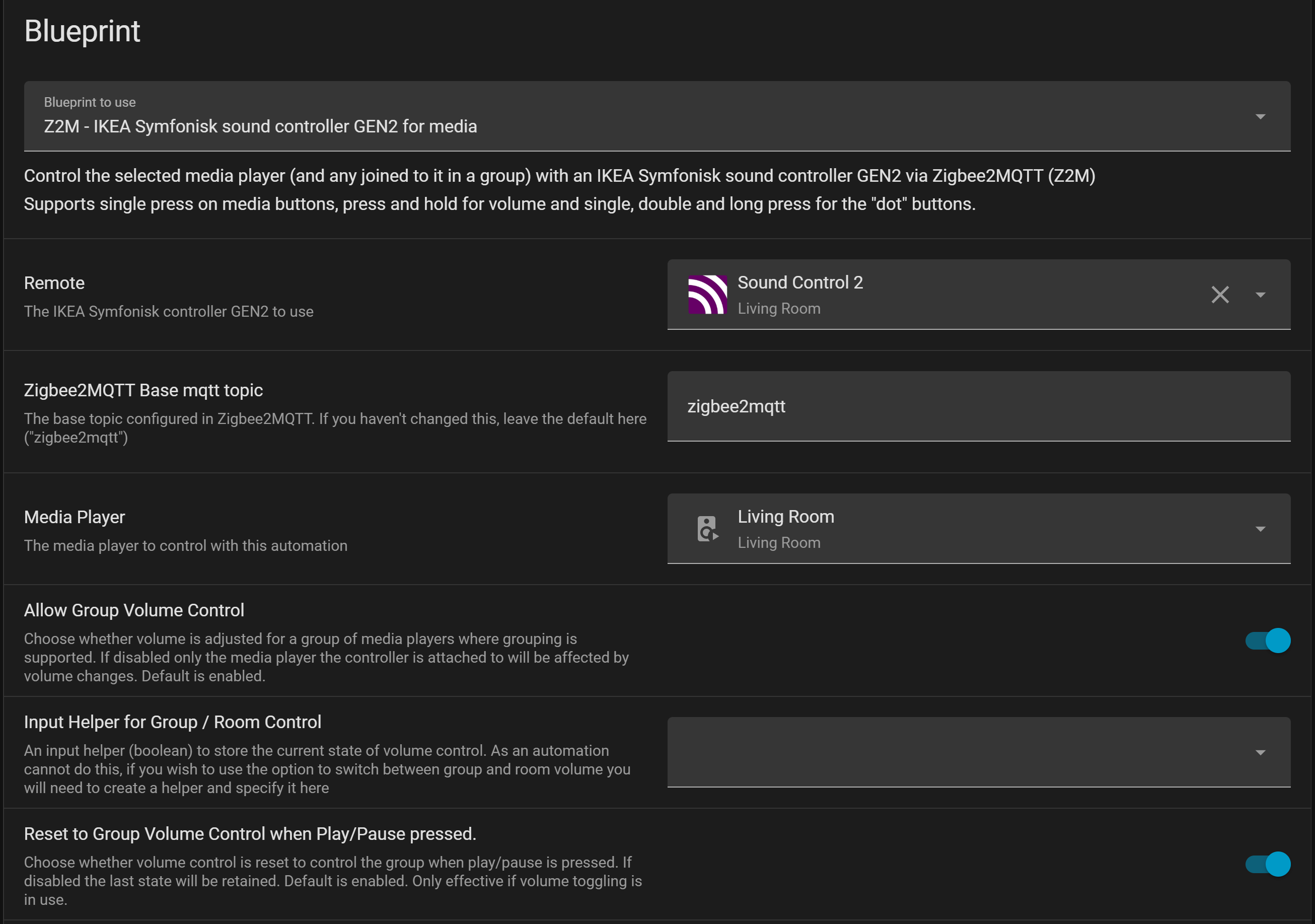

This is a blueprint to support controlling a media player with an Ikea Symfonisk Gen2 remote. It’s designed to work with the device added via Zigbee2MQTT (Z2M) only.
I wanted to allow for the use of more than one of these devices but also avoid the need to find and copy and paste topic strings from the entity MQTT settings. You can just select your device from the list :slight_smile:
Hope you find it useful.
NOTE: It’s best to select “Legacy = False” in the specific settings for your controllers in the Z2M config if you’re still using a version that supports this setting.

Setup
Basic Configuration
Select your Symfonisk Gen2 device, adjust your MQTT base topic if required, and choose a media_player to control (or a media_player that will act as the main device in a scenario where other players are grouped with it).
Dynamic Volume Control (Group vs. Room)
You can choose to disable group volume control by using the Allow Group Volume Control option, it is enabled by default. If you want to use the option to dynamically switch between controlling the group volume and just the room volume, you must select an Input Helper (Boolean) to store the state. If you have multiple Symfonisk devices and use this Blueprint with multipe automations you will need an input helper per device.
By default volume control will revert to group when Play/Pause is pressed, if you want to prevent this behaviour, turn off the Reset to Group Volume Control when Play/Pause pressed setting.
Use the drop down to select which button on the Symfonisk to use to switch between Group and Room volume control. Note: If you’ve previously set an action on the button you select to switch between Group and Room volume control, it will no longer fire.
The Volume Control Toggle option can be used to fire an action when switching between Group and Room volume control. This is useful if you have dashboards, indicators or other physical items you use to indicate state from your Home Assistant setup.

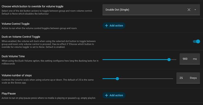

Volume Ducking
You can enable and configure volume ducking, which briefly lowers the volume to provide audio feedback when you successfully toggle between group and room volume control. The slider allows you to choose how long the volume is ducked for.
Custom Actions & Buttons
Configure the custom actions such as what happens when Play/Pause is pressed but no media is playing or queued and set up the actions for your “dot” buttons as needed.

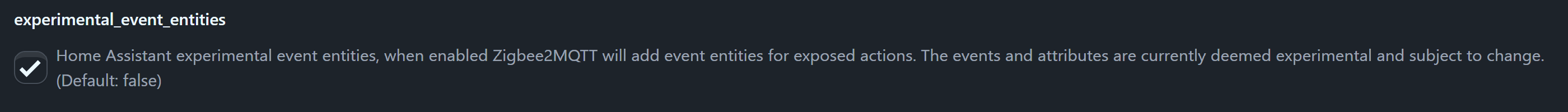

What I think might be viable is the Zigbee2MQTT 2.0 feature supporting Home Assistant Events - it creates an Action entity. It’s still experimental and needs to be manually enabled but I’ll investigate if this is doable as it should make the triggering much cleaner

@atus I have well and truly run out of options based on your helpful suggestion and a bunch of other ideas I've had. Due to limitations on inputs or more importantly, the limited templates affecting trigger variables. The duplicate message issue doesn't look like it's going to go away and if it does, there's still an issue right now affecting multiple users.
However, the direction of HA is moving towards event entities so I've migrated over to use this. It does mean I can't filter on the device as well as before, entities can't be filtered by device they are attached to in an input. It does decouple the device from the event though which is probably a good thing longer term. It is still classed as experimental in Z2M but I'll track progress and update as required.
To use events you need to go to Zigbee2MQTT settings, choose Home Assistant Integration and enable the setting below and restart Z2M. It will then add an event entity called "Action":
Here's a direct link to the v3.00 yaml for testing, I can't see any difference in behaviour from a quick test on my setup but if you wouldn't mind having a look that would be appreciated.
If this works out I'll add it as a formal option in the docs until such a time as events become "final" :slight_smile:
Yes, V3 is working! Thanks Shawsky!
