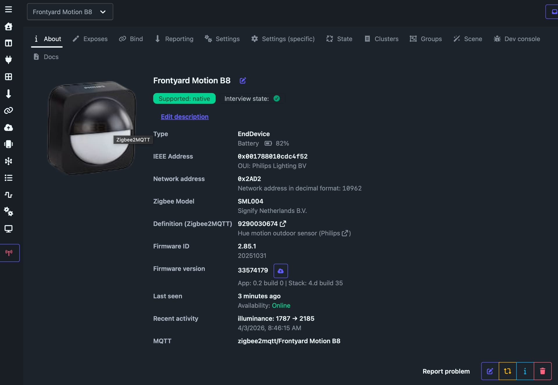

I hit the REPORT PROBLEM (from the ABOUT tab for the device) for one of my outdoor motion sensors after confirming I also saw the same.
It brought me to Github to file a report - but first I hit the link to see if the issue was already reported, and it was:
https://github.com/Koenkk/zigbee2mqtt/issues
I was able to do an OTA downgrade though the Windfront frontend, on one of the SML004 sensors (this also affects SML002 indoor motion sensors). I’m waiting a bit to see how much it affects the battery drain, and/or how long an update takes, before downgrading the others.
