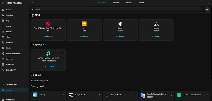

So my SONOFF Zigbee 3.0 USB Dongle Plus zha is in my ignored list do I need to move to disabled?
Probably yes and what I usually do is to unplugged coordinator and plug it int, And then restart z2m. Usually helps.
So I have disconnected SONOFF, checked SONOFF integration is ignored, restarted HA and after plugging SONOFF back into USB on HA I restarted Z2M but still getting same error message and Z2M doesn’t start

Also, can you share a screenshot of your integrations page? I have a feeling you had 2 autodiscovered integrations - Sonoff & ZHA, but you only disabled the Sonoff one.
