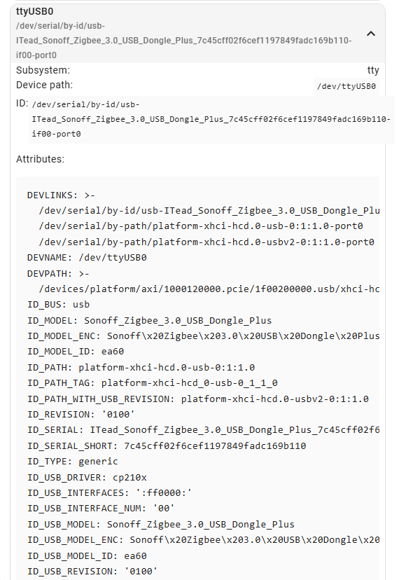

I have been trying to setup Sonoff_Zigbee_3.0_USB_Dongle_Plus with HA and Zigbee2MQQT with frustration and no success.
I have read alot od the forums on this topic and watched lots of youtube videos with no success.
Sonoff device:

serial:
port: >-
/dev/serial/by-id/usb-ITead_Sonoff_Zigbee_3.0_USB_Dongle_Plus_7c45cff02f6cef1197849fadc169b110-if00-port0
permit_join: true

I just solved it. Deleted the port information that I hardcoded and went through the onboarding and manually selected the USB device…bingo worked
