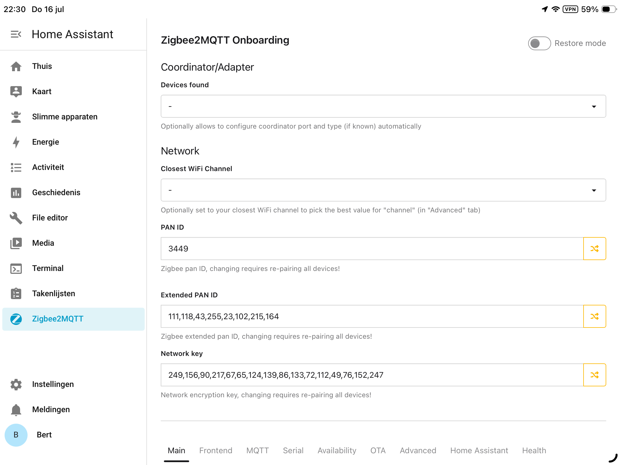

Zigbee2mqtt onboarding screen
I have tried to install zigbee2mqtt, have followed instructions to do so, and have switched off ZHA. But when i klick on the ‘zigbee2mqtt’ menu-option i only get a zigbee2mqtt onboarding screen. What do i miss?
I work on a home assistant green and a sonoff zigbee usb e dongle . And With the ipad-app as userinterface.
Did you fill in all the fields in the onboarding screen?
What should i fill in?
No, i didnt fill in anything. Don’t know what to fill in.
Getting started page for Z2M is here Getting started | Zigbee2MQTT. At the very least you need to select the adapter on that page, then fill in the missing details in the frontend & mqtt tabs at the bottom of the page.
And make sure when you are successful setting this up, you have different numbers in those last 3 fields. Those or basically passwords and you shared the ones on that screen with us.
Ok, thx for the tip. Ill change it.
And the problem is already solved.
Hi, pan id’s and networkkeys have been changed. Thanks again for the tip.
