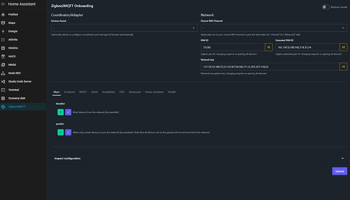

Zigbee2MQTT problemsssss
When click on zigbee2MQTT - start "Zigbee2MQTT Onboarding"
What now, or where is the problem?

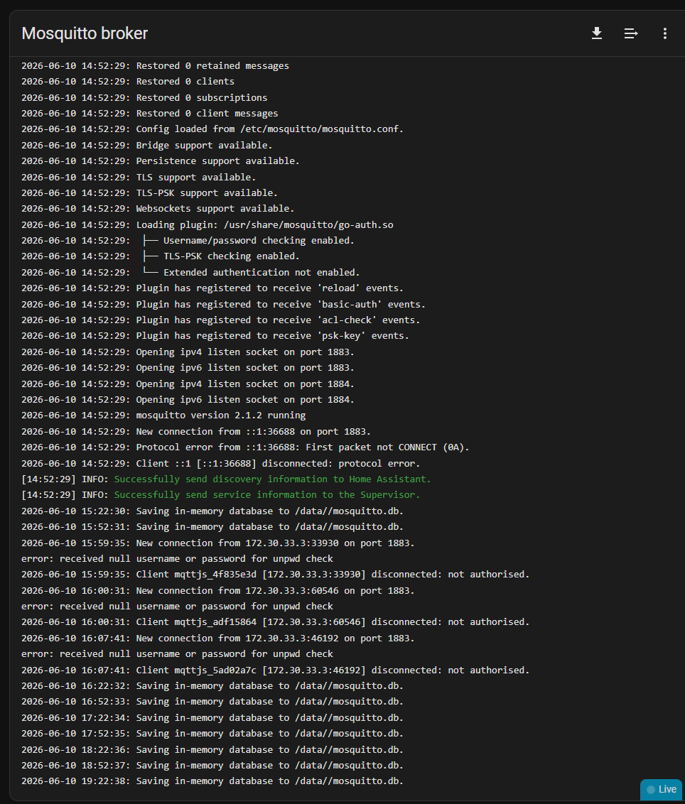

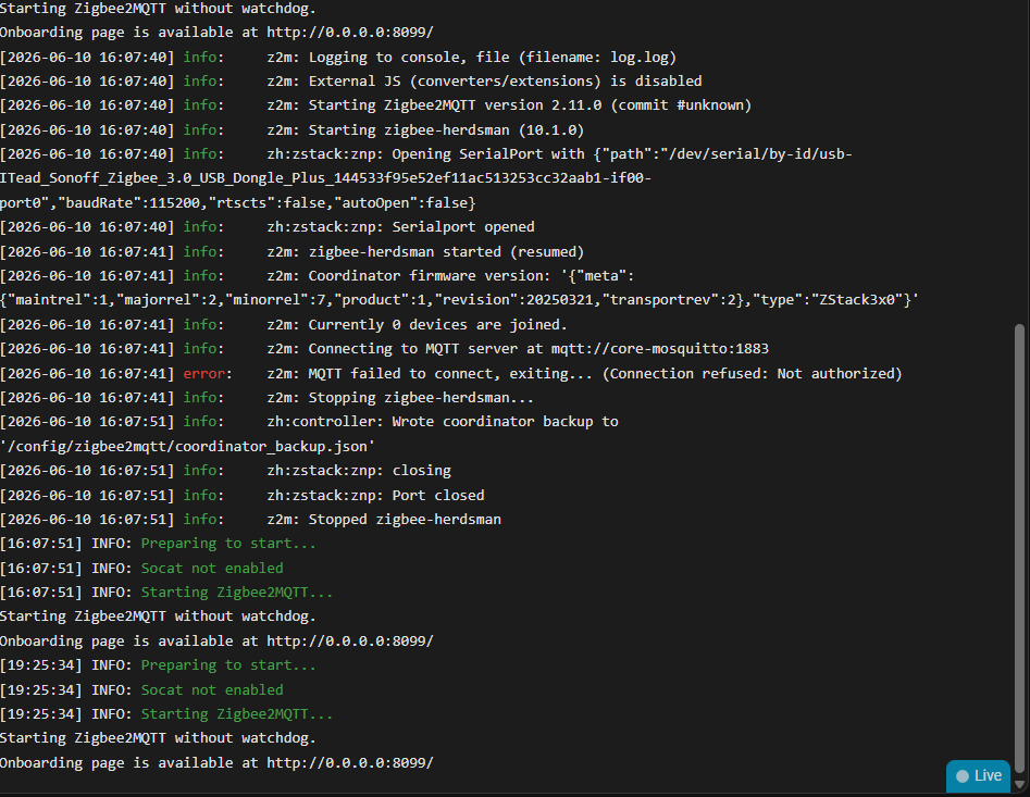

From your error it is clear that the MQTT connection is not working.
Can you explain how did you install it?

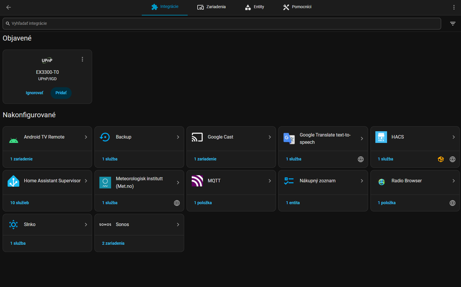

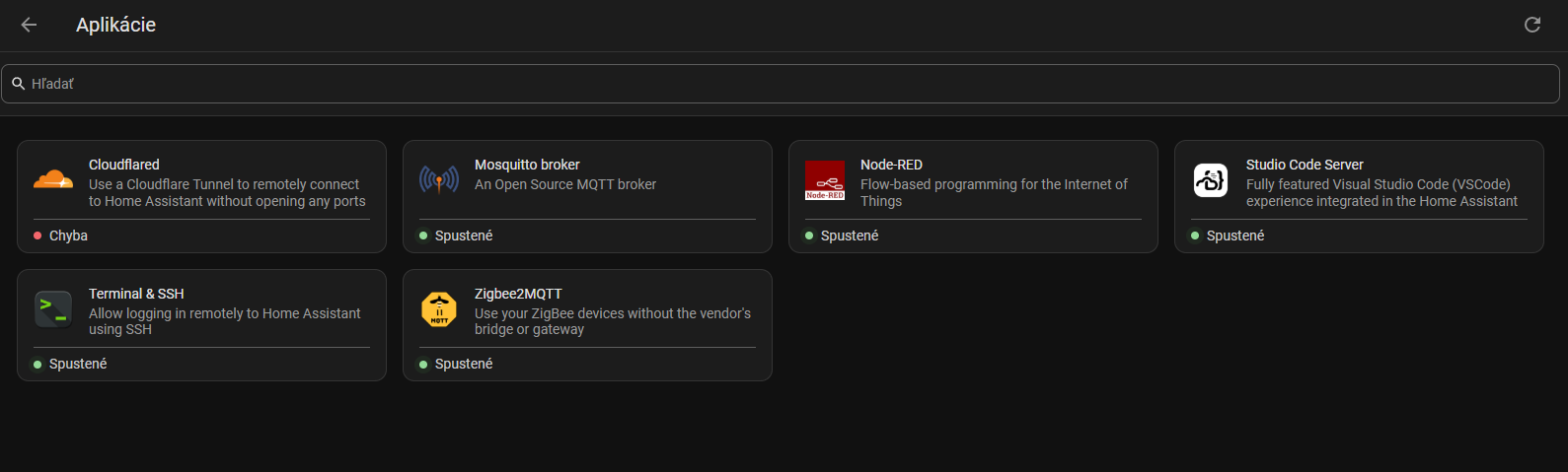

HA Addon/App
I installed "Mosquitto broker" and "Zigbee2MQTT" app and "MQTT" integration

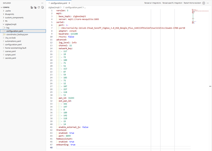

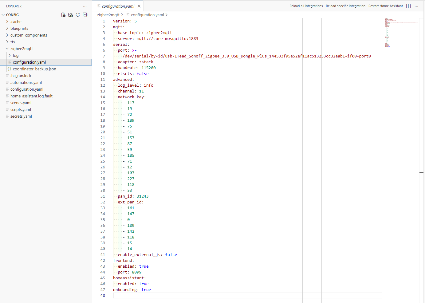

You're missing a user & password for MQTT in Z2M config. You won't be able to connect to MQTT until you set one up.
I setup username and password in zigbee2mqtt.
The result is the same
OK
I don't know what exactly happened. I created a new user and entered these logins in the zigbee2mqtt settings and then it worked. I deleted the second user and after a reboot, everything works
