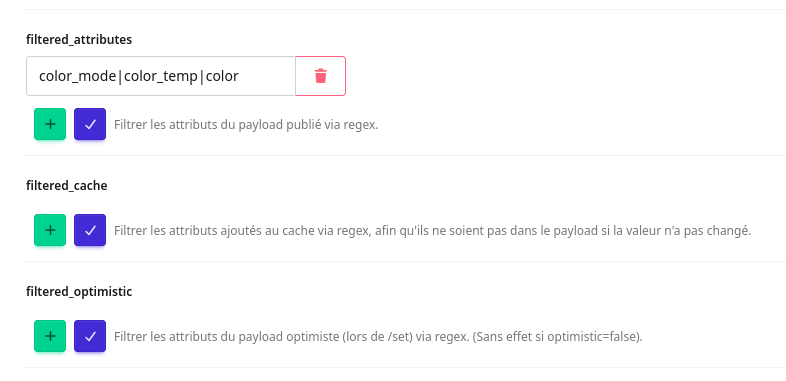

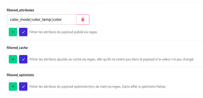

I’ve been able to work it out too by filtering those attributes in Z2M parameters for each bulb. Probably easier and more safe.
Regex :
color_mode|color_temp|color
