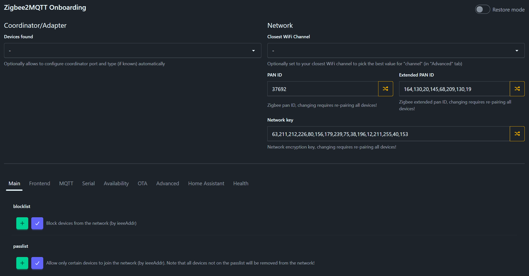

Onboarding page is available at http://0.0.0.0:8099/
The given page can not be accessed.
After hitting: open web UI (or open it on the sidebar), I select my ZBT-2, and no matter what else I change (there’s nothing else here needs to be change supposedly), the UI won’t load. (as the onboarding page can not be accessed).
(Also, I don’t understand this: “Fill in the Closests WiFi Channel to select the most optimal Zigbee channel”. Which one should I select for what? Should I just leave it on ‘-’?)

Page won’t load, opening Z2M again will take me back to the onboarding page:
After changing the (auto filled) config to this:
adapter: ember
baudrate: 460800
rtscts: true
Different logs will come, without error, but localhost still rejects and frontend won’t load.
