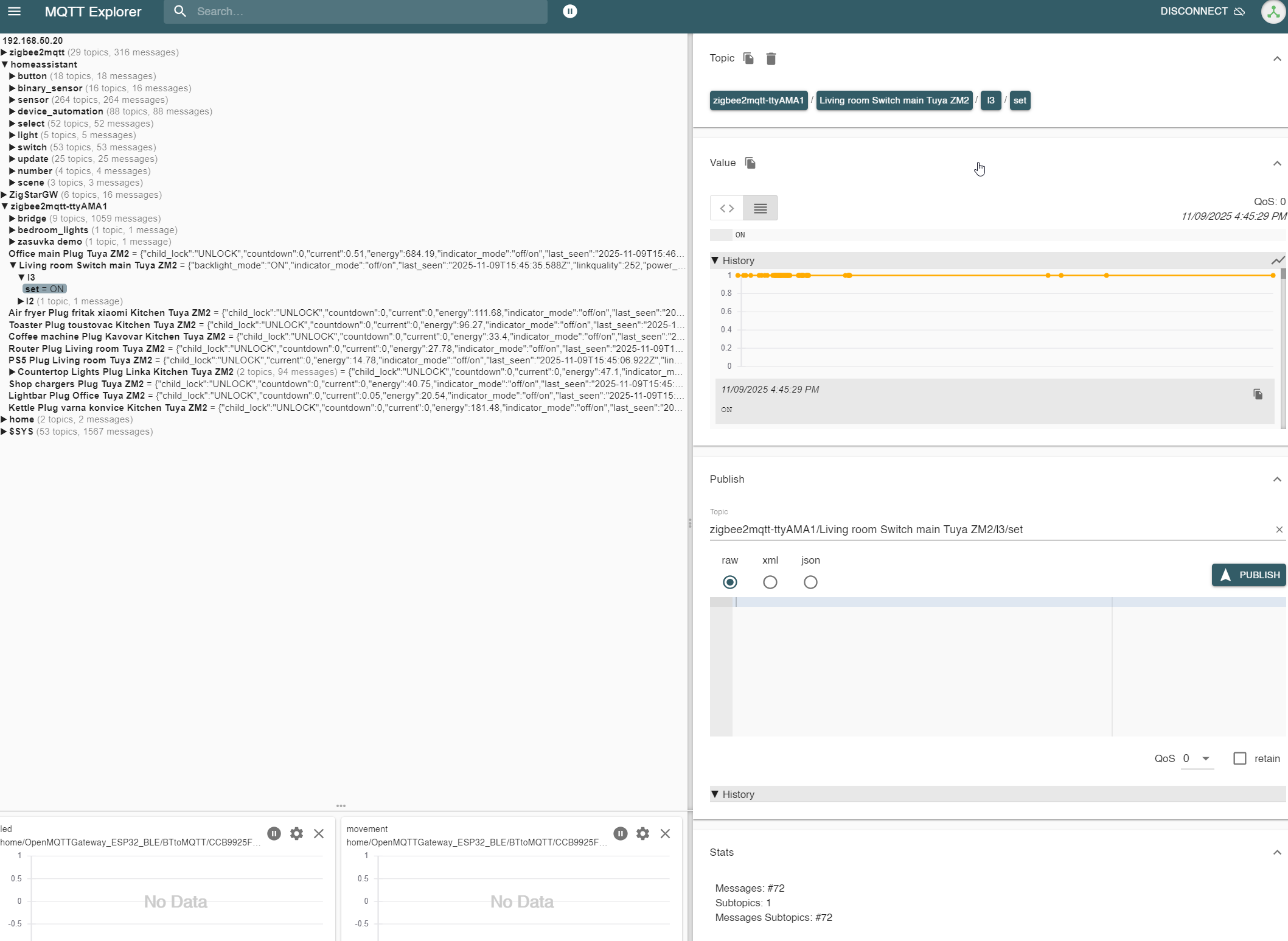

When i connect to mosquito broker running as addon using https://mqtt-explorer.com/ i do see messages like this that should be comming from home assistant
{"backlight_mode":"ON","indicator_mode":"off/on","last_seen":"2025-11-09T15:37:21.638Z","linkquality":252,"power_on_behavior_l1":"previous","power_on_behavior_l2":"previous","power_on_behavior_l3":"previous","state_center":"OFF","state_l1":"OFF","state_l2":"OFF","state_l3":"OFF","state_left":"OFF","state_right":"OFF"}
When i press button to turn on the switch in HA message count in mqtt explorer and that is only message i see there
This is how it looks (count increases each time i press in HA) and nothing then in z2m log
