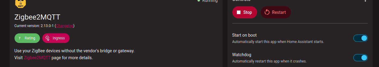

I does start if I click on ok but I don’t understand why the watchdog does not automagically restart it. I have the watchdog set as 1,2,3,4,5,7,10,15,20,30,45,60.

Assuming you are running in HAOS, I was referring to the watchdog button in the info section of the Z2M App that is supposed to restart the App if it stops. This doesn’t have options that I am aware of.
That’s what is in the screenshot.
I think the watchdog for Z2M actually does nothing unless you have the intervals set in the options like sdegonge has.
