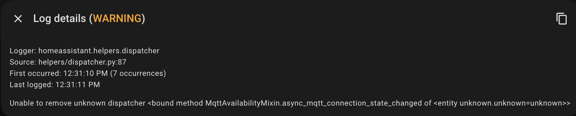

I’m just about at the end of my ropes and not sure what is going on. When I change the name of a device with in zigbee2mqtt interface, i get the following errors and warnings in my HA Core logs. I have posted the screenshots of the errros and my version of HA. For record I am using a brand new SLZB-06 coordinator. I had the same issues with my Sonoff dongle as well. At this point willing to pay someone for helping me fix this. I completely uninstalled both the mqtt broker add on in HA and z2m add on. I’m still getting these warnings and errors . The device works, i just dont know why this happens

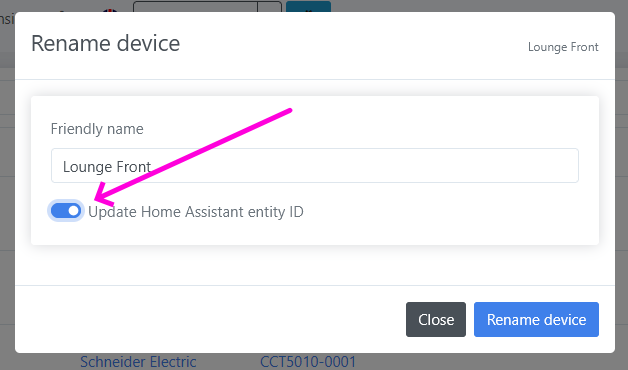

When you change the name in Z2M are you making sure you turn this on?
What is a converter ?
Yes I do checks that box. The issue isn’t that the name doesn’t change in HA. It does. It’s that those errors show up. Also whether I check that box or not , the error show up.

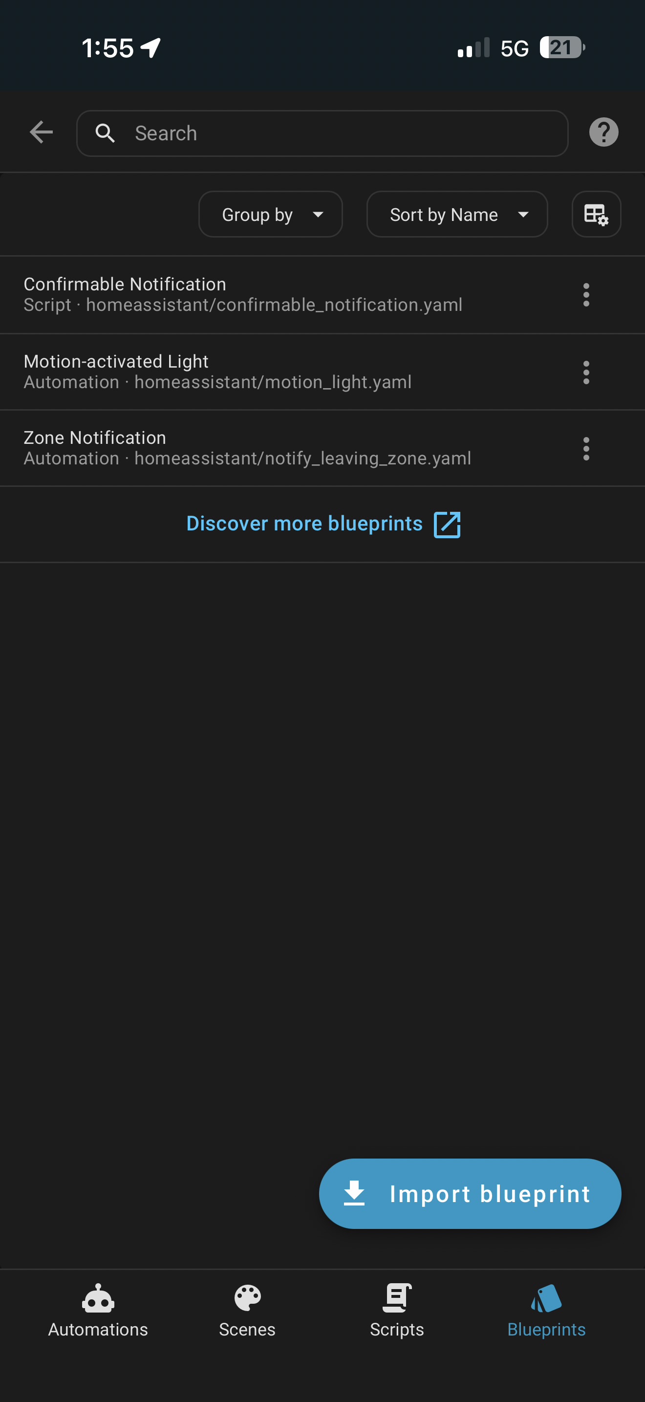

Have you imported any blueprints?
The errors seem to suggest that some script, automation, or other thing that can use Jinja templates is assuming that messages from a particular device have those value_json fields.
I could be wrong, but I think errors like that, which reference Jinja syntax (the {{ and }} delimiters) are due to something that you would have yourself created or imported into HA.
I believe these are what HA came with

To be clear, are your devices working properly after the rename? Are you seeing these errors continuously, or only once straight after the rename?
I think I’ve seen similar on adding new devices, or more specifically enabling device sensors that are disabled by defaullt, such as link quality. But I just ignore them assuming they are only momentary errors which happen before sensor values are actually populated with data.
If your devices are actually working fine, I wouldn’t worry about it.
As far as I can tell the devices do work fine. It’s when I rename them in z2m, I see these warnings and errors in the HA core log
The I definitely think you’ve got nothing to worry about.
