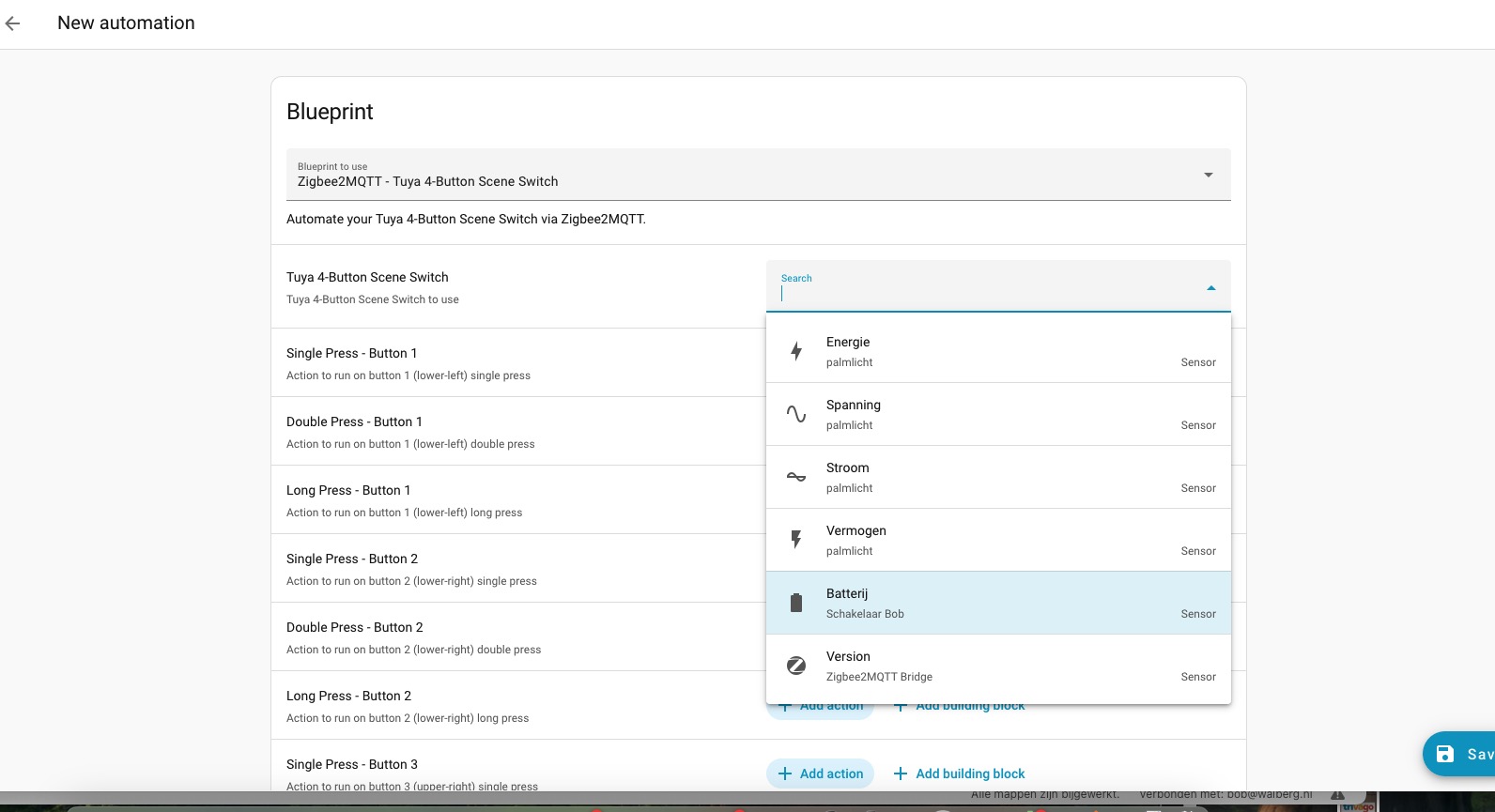

I tried the original blueprint, but see picture, i think as most of the times, devices are first unavailable, too bad i use zigbee2mqtt so there is no device list as normal ZHA do. I have a Tuya (oem) 00044 so with 4 buttons, and i call it in Zigbee2mqtt: Schakelaar Bob and the 4 lamps are Boblamp1 Boblamp2 Boblamp3 Boblamp4 but as you can see, they are not in the pull down
