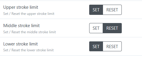

Did you find a way to set upper and lower limit for this motor. I tried setting stroke limit but it doesnt work.

having the same issues. can get the blind paired, but only up/down/stop functions are working. cannot get limits and motor reverse working. I’ve tried adding the external converter, but it doesn’t seem to make any difference
