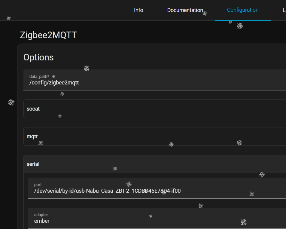

The TTY ports can sometimes change internally, so it is suggested to use the /serial/by-id/ URL that always talks to your dongle by serial so it is always right.
You can find out what that is by using:
and looking for it under all hardware, something like this:
Once you have the long URL use that instead of the ttyxxx one.

you put that device id path in the zigbee2mqtt addon settings
then reboot your host, then check the z2m logs after restart
