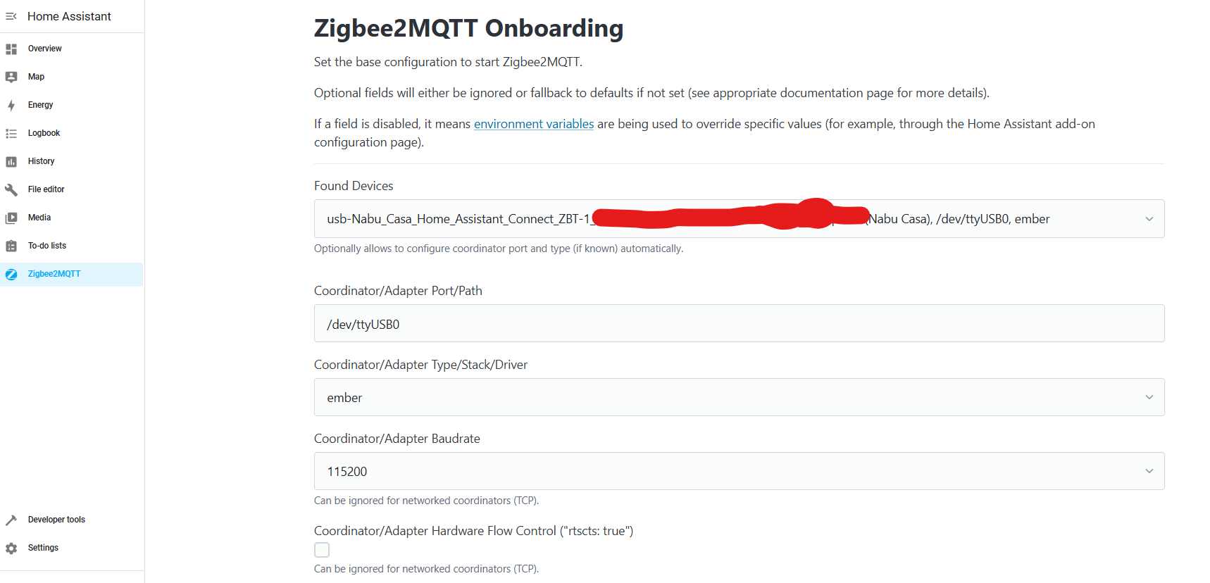

I have performed the followings:
  • Uninstalled the zigbee2mqtt add-on
  • Unplugged the Home Assistant Connect ZBT-1 and re-plugged into another USB port
  • Reinstalled zigbee2mqtt add-on
  • Started the zigbee2mqtt add-on
  • Followed the "On-Boarding: steps:
  1. selected the zigbee antenna from the drop down
  2. Kept all the other settings as default
  3. Starter the Service
and got the following error:

No, you need to UPgrade the coordinator (antenna) firmware.
That error shows you a troubleshooting page. You are specifically looking for this part
