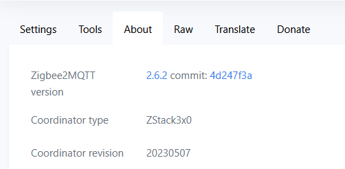

You won’t see it here
only here what coordinator you have
Indeed, the coordinator is not seen. My mistake, I just transferred my HA instance from RPI4 to an Intel NUC and finished Z-Wave. With Z-Wave, the coordinator is shown in the UI. And I could not remember if that was also the case in Z2M; but i was mistaken.
