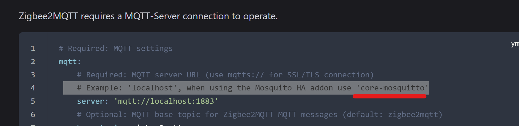

server: mqtt://core-mosquitto:1883
server: mqtt://localhost:1883 does not work with the Mosquitto HA addon
