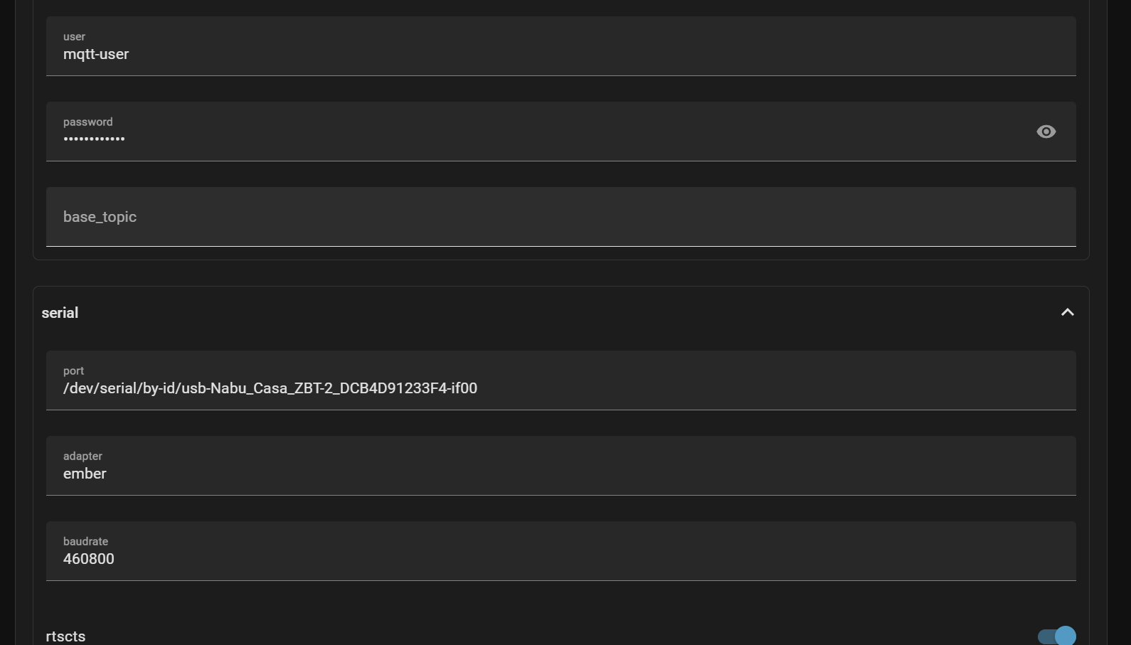

Hi all.
I have issue to make it work with ZBT-2.
This is my configuration and I see these error logs and I cannot figure it out. Have you any idea please?

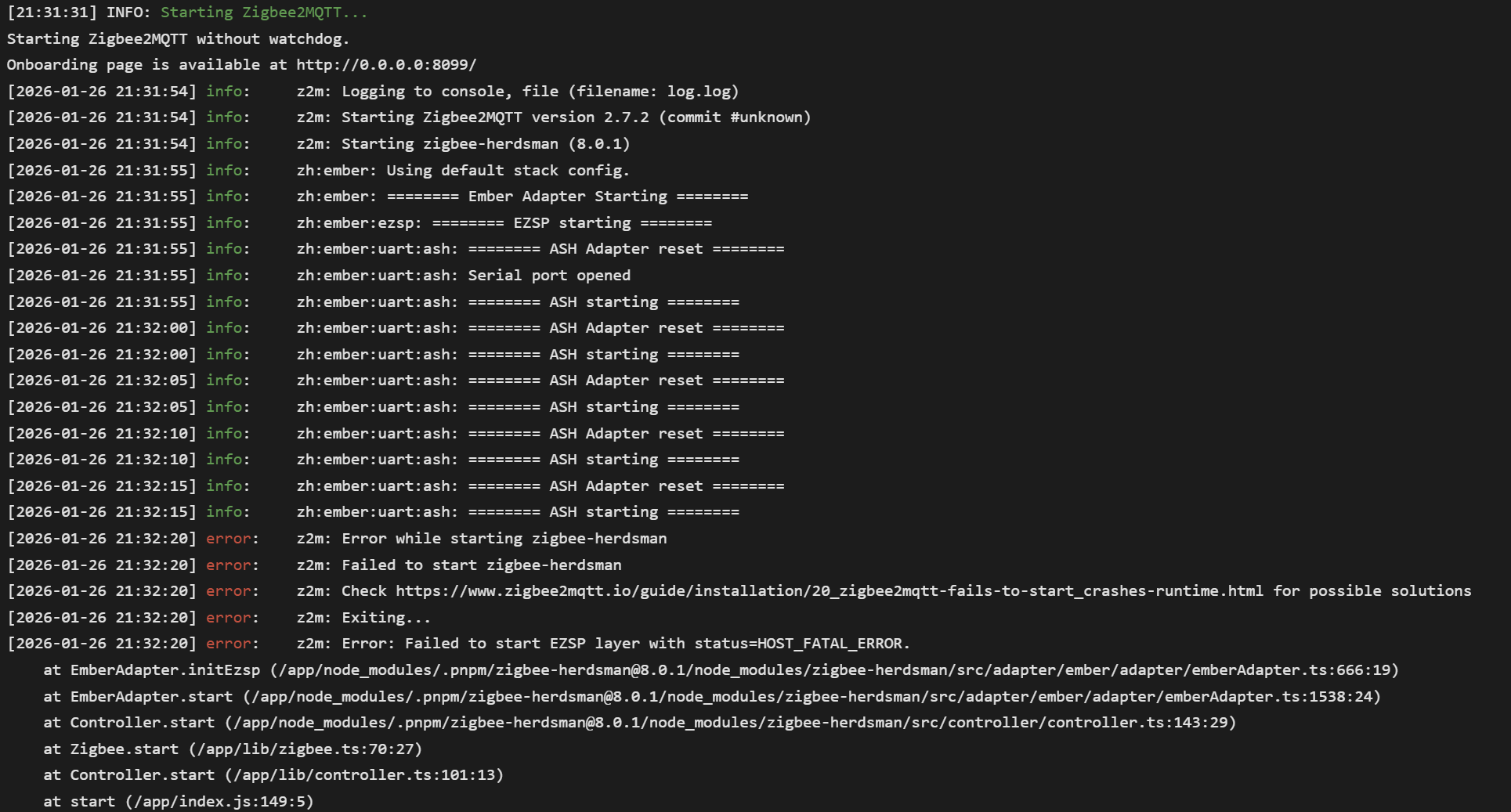

And these are logs:
[2026-01-26 21:32:20] error: 	z2m: Error while starting zigbee-herdsman
[2026-01-26 21:32:20] error: 	z2m: Failed to start zigbee-herdsman
[2026-01-26 21:32:20] error: 	z2m: Check https://www.zigbee2mqtt.io/guide/installation/20_zigbee2mqtt-fails-to-start_crashes-runtime.html for possible solutions
[2026-01-26 21:32:20] error: 	z2m: Exiting...
[2026-01-26 21:32:20] error: 	z2m: Error: Failed to start EZSP layer with status=HOST_FATAL_ERROR.
    at EmberAdapter.initEzsp (/app/node_modules/.pnpm/[email protected]/node_modules/zigbee-herdsman/src/adapter/ember/adapter/emberAdapter.ts:666:19)
    at EmberAdapter.start (/app/node_modules/.pnpm/[email protected]/node_modules/zigbee-herdsman/src/adapter/ember/adapter/emberAdapter.ts:1538:24)
    at Controller.start (/app/node_modules/.pnpm/[email protected]/node_modules/zigbee-herdsman/src/controller/controller.ts:143:29)
    at Zigbee.start (/app/lib/zigbee.ts:70:27)
    at Controller.start (/app/lib/controller.ts:101:13)
    at start (/app/index.js:149:5)
Hi. Have you figured it out? I am facing the exact same issue right now.
UPDATE: restarting the HA-VM fixed the issue. The config above is correct.
