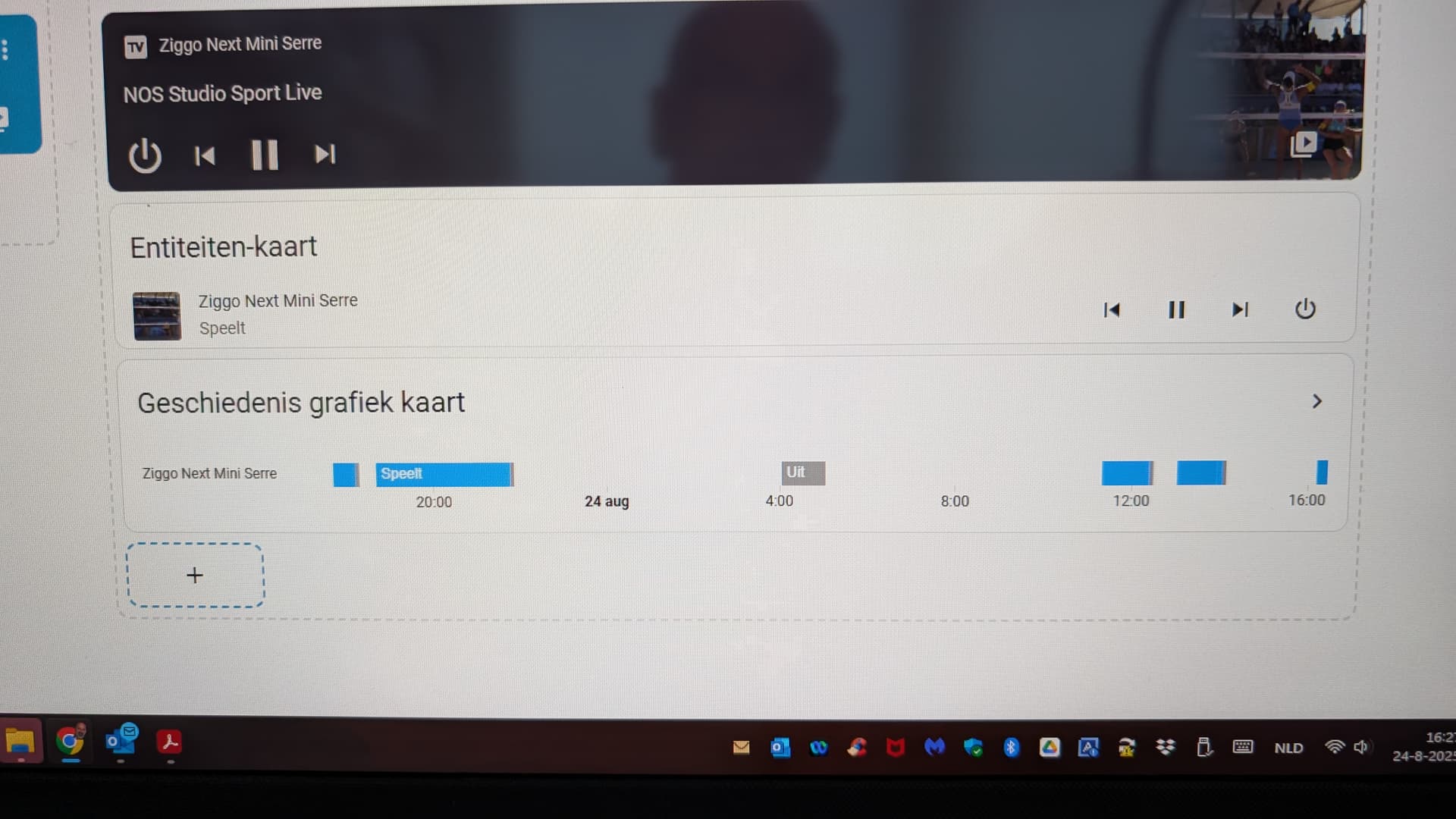

I am using my Logitec Harmony Ultimate to control my Panasonic TV and Ziggo Next (with coax cable), but could not use it for my Philips TV and Ziggo Next Mini (with ethernet cable), because the Mini uses RF signals instead of IR signals. So I ordered the new Unfolded Circle Remote 3 and the Home Assistant Green. Installed in Home Assistant your integration LG Horizon and also installed on the Remote 3 the Home Assistant integration including your LG Horizon. Now I can do some basic operations of the Ziggo Next Mini out of Home Assistant and Remote 3, but I want to use all the possible buttons, showed in your picture.
This is what I see in Home Assistant:
On the Remote 3 is get two pages:
  1. the first page is a mediaplayer widget of what is playing on the Ziggo Next Mini, with a button to the second page.
  2. the second page is a scrollable list of buttons of all tv channels.
    So, I see what is playing and I can select another tv channel, but I cannot operate the Ziggo Next Mini with the buttons.
What I am missing is a screen with the possible buttons.
How can I in Home Assistant make a mapping of all possible buttons and include them in the inegration, so that I get an extra page or more pages in theh Remote 3, where I can press these buttons or map them to the physic buttons on the Remote 3?
Could you help me how to setup this in Home Assistant, because I do not understand how to implement what you describe under Custom Services?
