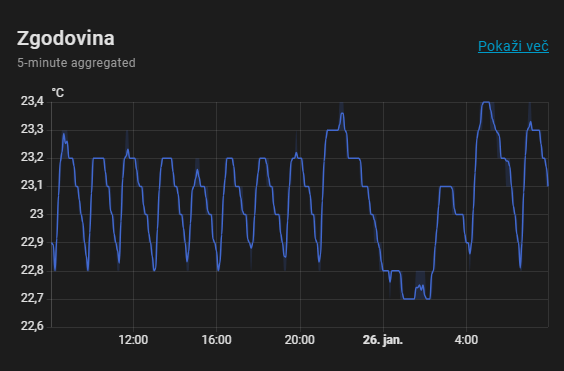

My house is not insulated, so i have a similar problem - different temperatures across the rooms - and it’s hard to control them with only one “main” thermostat. So i installed Sonoff TRV’s on my radiators, and i use them with external temperature sensor (xiaomi BLE), installed way away from the radiator, to report actual temperature. I have sonoff’s connected to HA via ZHA (now i’m also testing Z2M, and it also works, but it’s more work to setup). Results are more than excellent (for me at least). Temperature is constant to appr. 0.5 degree (termp.is set to 23):
Note that drop below 22.8 is the result of lower night temperature in the stove, so radiator temperature actually doesn’t reach needed temp. to successfully heat up to 23 degrees.
