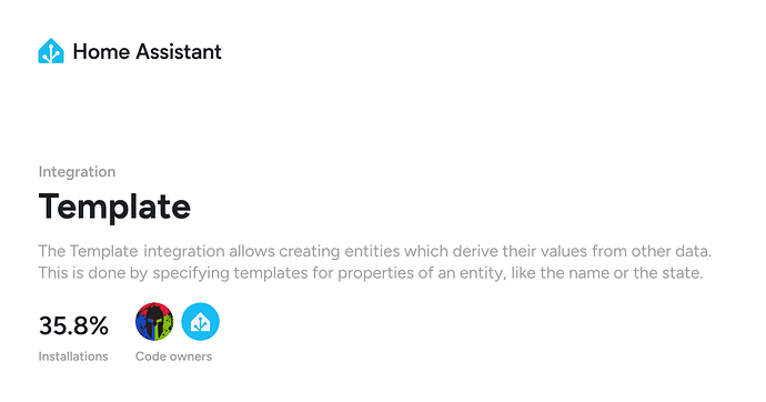

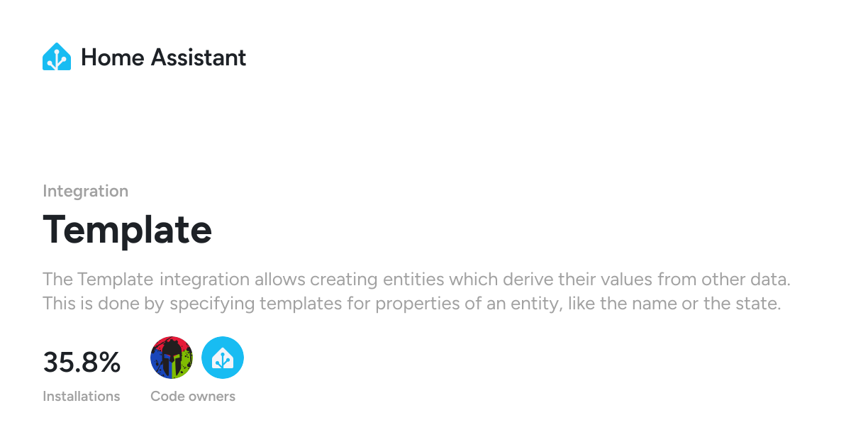

You may be able to avoid the problem if you move to the new way, which is to define a template device tracker helper (new functionality) instead of using known_devices (also deprecated for years now) and device_tracker.see

Thank you for the support, using the device tracker template I solved my problem.
