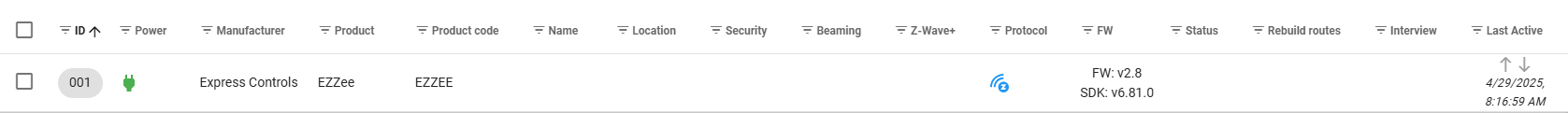

You should see your Z-Wave stick in Z-Wave-JS-UI as Node 001. Nothing else will work until the controller is connected.

From the Z-wave JS UI screen, post some images of your controller like this:
We’re specifically interested in the “last active” and statistics

I’m limited to only posting one pic. Maybe it’s a forum restriction for new users. So here are the statistics from tonight.
Here is one more of the status of the controller.
