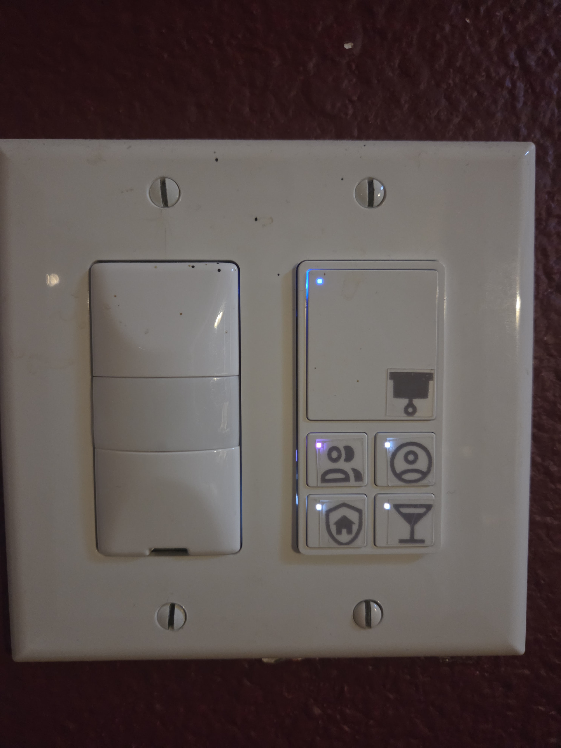

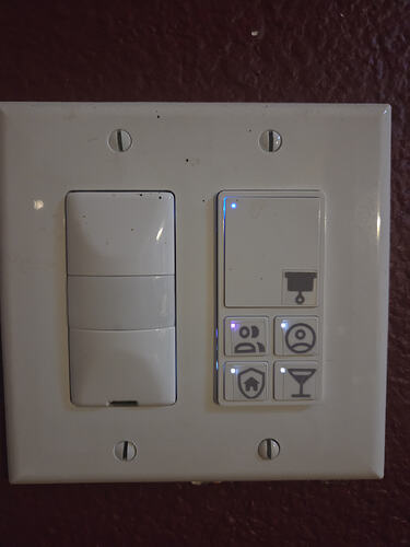

You can do just about anything you want with it. I use most of mine to control the fixture they’re hooked to and the rest of the button led as state indicators and dropped some transparent stickers onthe faces so people know what they’re clicking
For example..
That occupancy (the two person icon) indicator magenta solid is telling me the room is on hold. It also tells me I forgot to move the entity for entertaining mode (the cocktail glass) is showing off (but I edited that entity this weekend for the house and apparently forgot this one… :rofl:) even though it is functionally on driving that magenta blinky.. :smiling_face_with_sunglasses:
Also holy carp seeing the speckles - when I dropped that cup it sprayed all the way up there! :rofl: *grabs a rag and windex.
