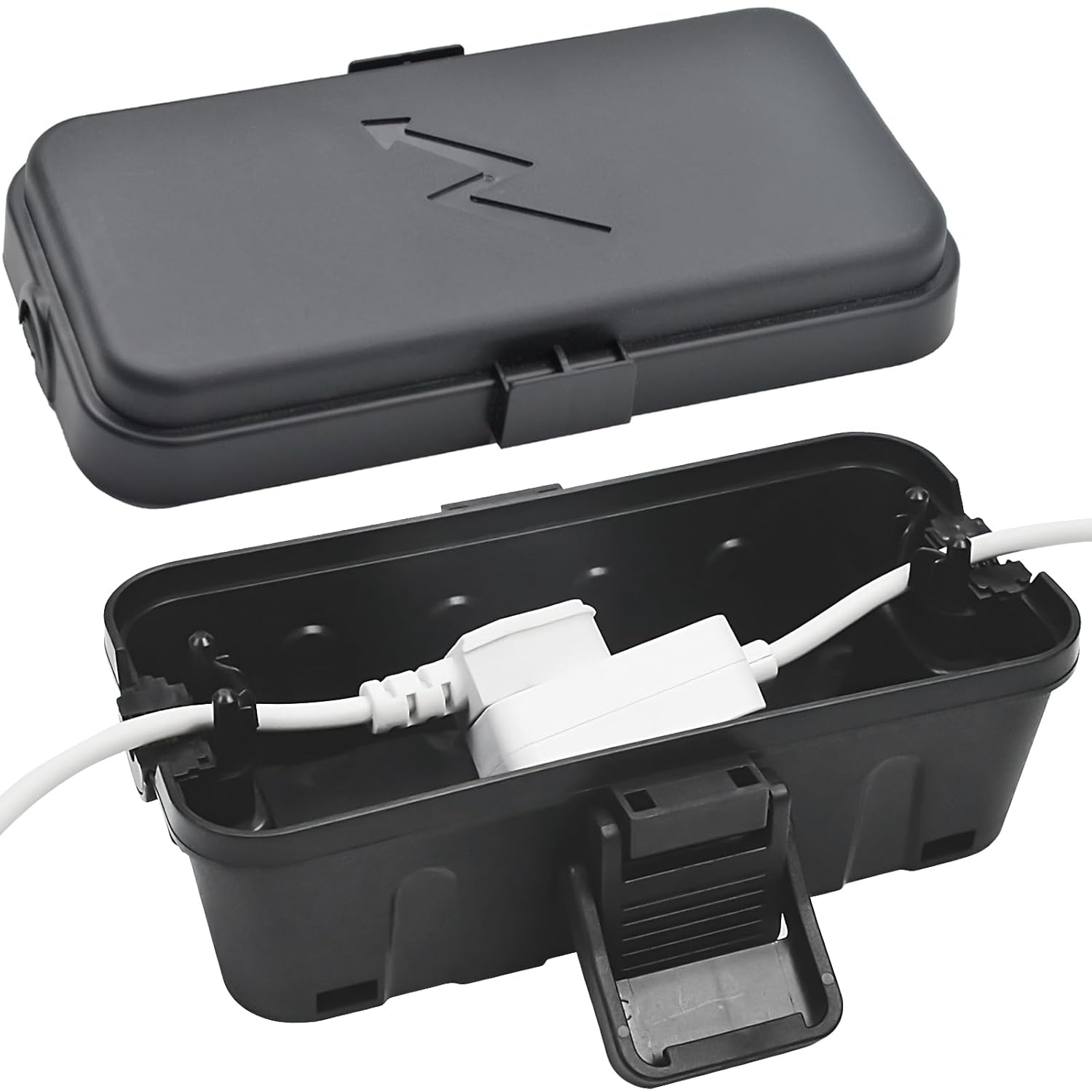

The pump is outside and the zen15 is in one of these but the medium size.

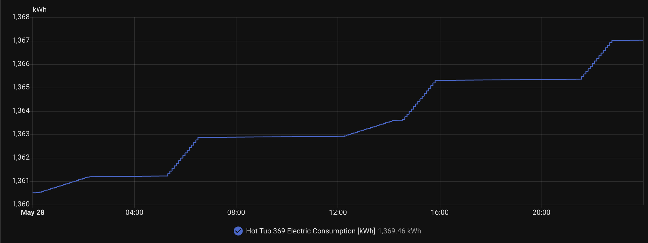

I have a Zen15 in a similar box running a 1.5hp pump and heater for a 120v hot tub. So similar load.

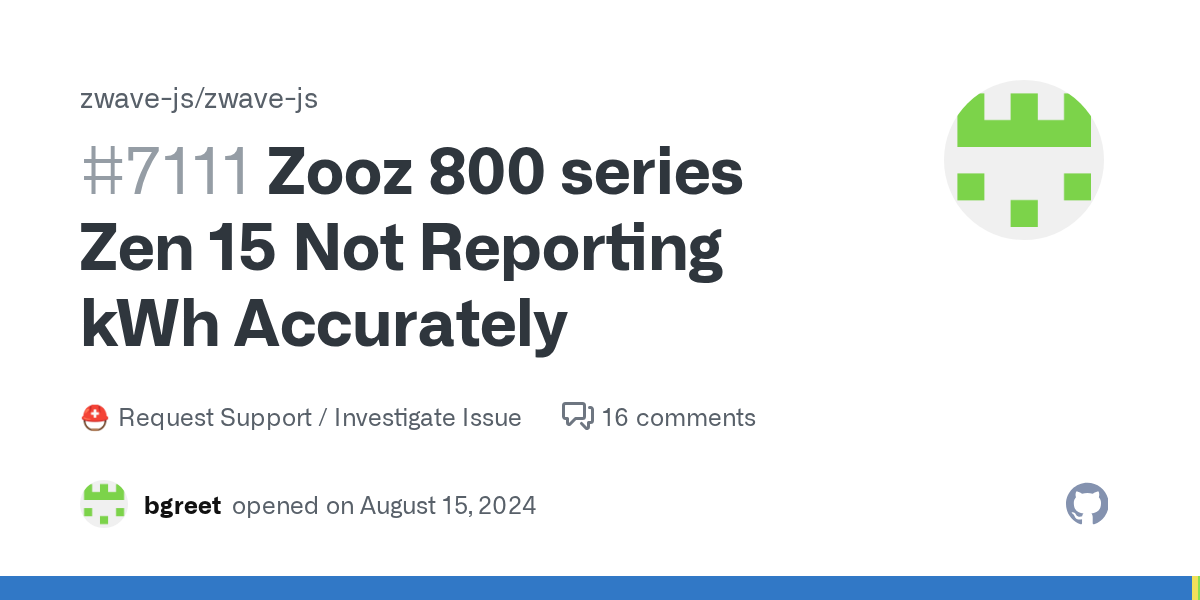

There is a bug in the zen15 where the auto-off timer isn't reset correctly. That causes devices to prematurely shut off in some cases.
It’s a well known problem. I am looking for an alternative to it, but it seems as if there isn’t one. My device is 9.5 amps instantly when turned and it has reported 10 and 5 amps where my zen05 reports 9.5 each time.

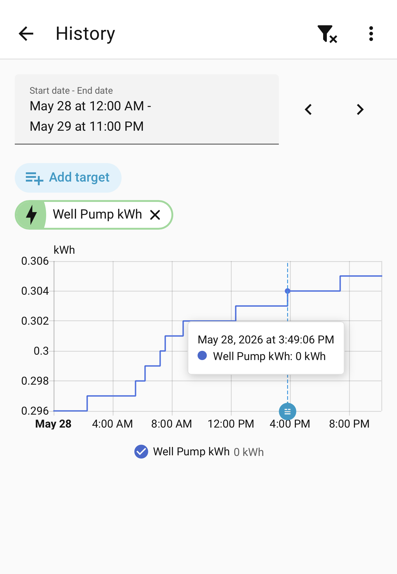

Go into your voltage history and see if it dropped to zero at any time over the last month.
I cannot fix it as zooz is in denial about this. I’m looking for another option.

Thanks for the link. I guess I've been lucky. I have eight of them and I haven't seen this jumping of power. None of mine show a voltage drop to zero. All solid.

Which align with when it is using power:

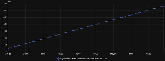

Here's the dryer that's not running.

No matter where I check along the graph, it says zero
