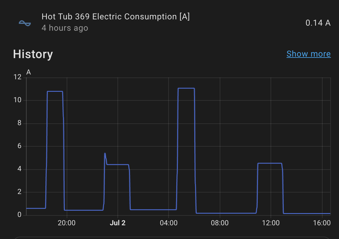

I have a Zen15 on a 120V hot tub. It wasn’t clear if it would handle the hot tub and the startup current, but seems to do ok so far.
