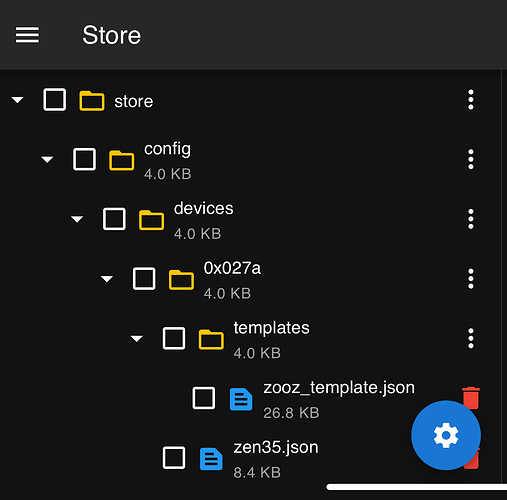

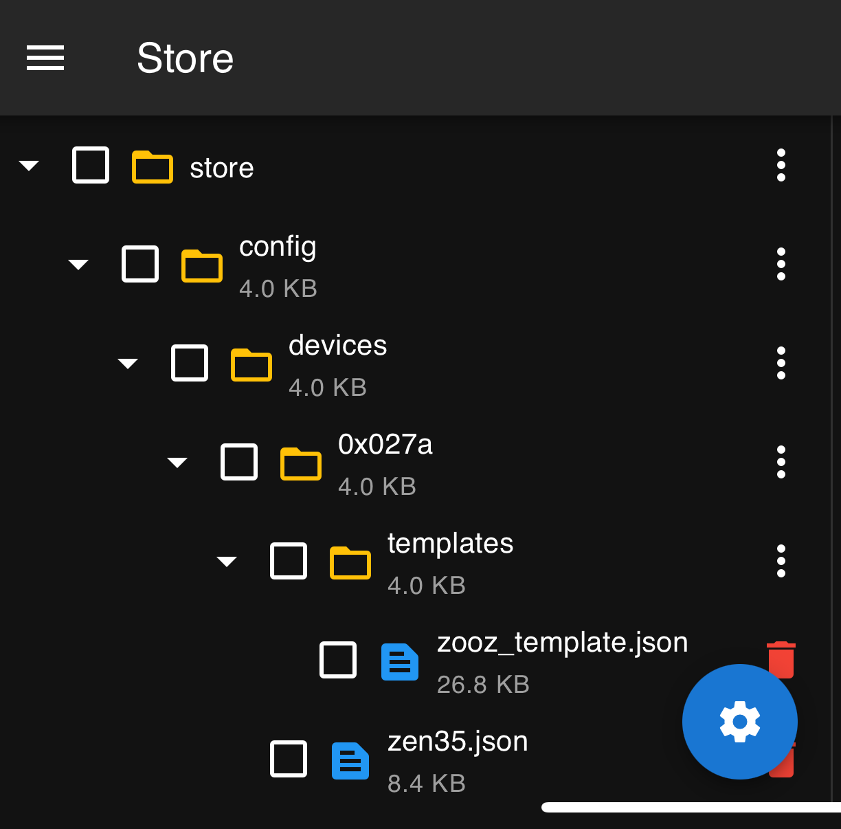

I cant seem to get Z-wave JS to identify the Zen35. I dropped your zen35.json file in store/config, but nothing is changing.
Did the same thing and realized you have to put it under store/config/devices/0x027a/zen35.json
You’ll also need the updated zooz template file (see screenshot)

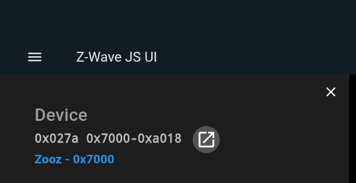

Even after today’s Z-Wave update that specifically included a new profile for the ZEN35, I still can’t get the Blueprint to recognize it. It sees my ZEN32’s, but even after re-interviewing and, when that didn’t work, excluding and re-including it won’t see the ZEN35. Worth noting is that in the Z-Wave JS UI it shows up as ā€œZooz 0x7000 Unknown product 0xa018ā€ unlike the others which have their type and model number. Any ideas?
Maybe you need to wait for the zwave-js update to be included in a zwave-js-ui update?
You are good now, right?
Yes, thank you!
