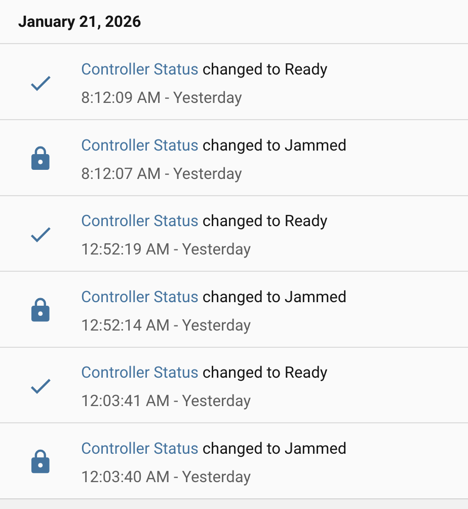

I just migrated from aeotec gen5 to zwa-2. I use zwave js UI. Where are you guys seeing the “jammed” error reported? In the zwave js UI logs?
In two places. On the Zwave JS UI nodes control panel in the upper right corner there’s a small banner that typically says “Ready” when the controller and driver are communicating properly. This will sometimes change to red and say something like “The controller is unable to transmit”. The other place is the sensor created in HA for the controller when you add the Zwave integration. It will flip between “Ready” and “Jammed”.
yup, i too am seeing jammed several times over the last 20 hours since i switched to zwa-2. It seems to only last 1-2 seconds. I suppose that is still an issue though if my system is trying to execute a command during that time.

Where would I be able to see if I have jams?
I don’t know how to pull it from hass directly, though that would be a great stat to have. I have been pulling it from my zwave-js-ui logs: zgrep 'The controller is jammed' ~hass/zwave-js-ui/store/logs/zwavejs_2026*.log* | awk -F: '{print $1}' | uniq -c. I run an old-school stand-alone instance, so I am unsure how you would access the logs with a more modern install.
Settings > Devices & Services > Devices
Search for “zwa-2” (or the name of your zwave controller).
Then look under the “Activity” section.
I get several “jammed” notifications per day but they only last for 1-2 seconds and I don’t really notice them otherwise.
I have mine sitting like 6-7’ from a mesh node for my router. I’ve been meaning to movie it… but I really don’t have any centrally located spot with a mesh node.
The is no activity. Does the activity need to be turned on?
Why can’t you look at the stick status? My zwave stick has a diagnostic sensor called status. This shows “ready” it should go to jammed when jammed?
Ah, there it is. I was too narrow in what I was looking for. I guess I would need a custom sensor to count the number of times it was in the state Jammed.
