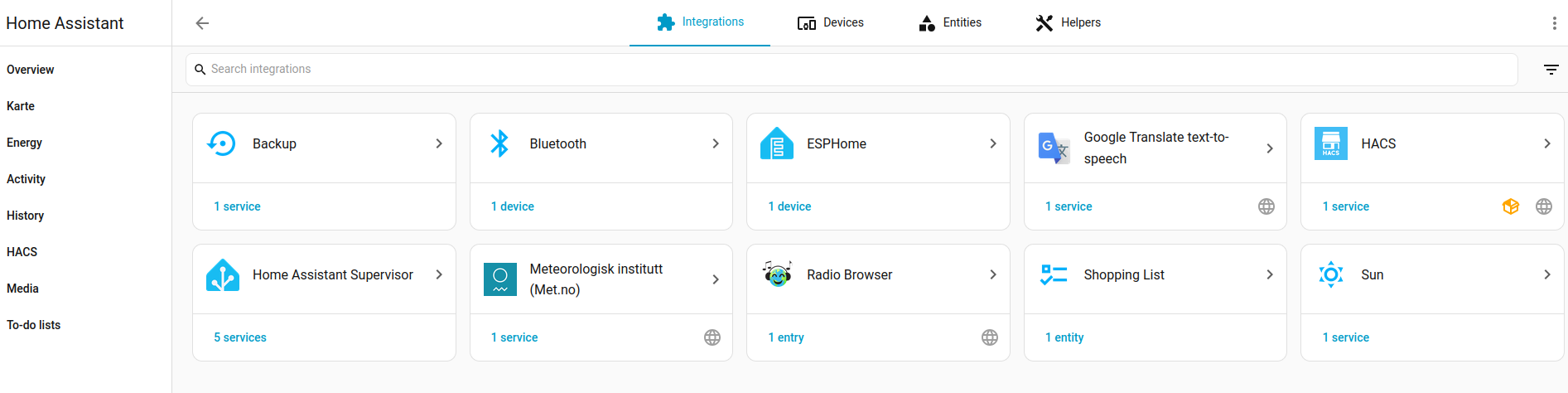

I checked for discovered ESPHome devices on the integrations page and configure the discovered device. Configuration means set up the name and the area.
Then I go back to the integrations page. I only see a new Bluetooth integration with the ZWA-2 device. But no Z-Wave.

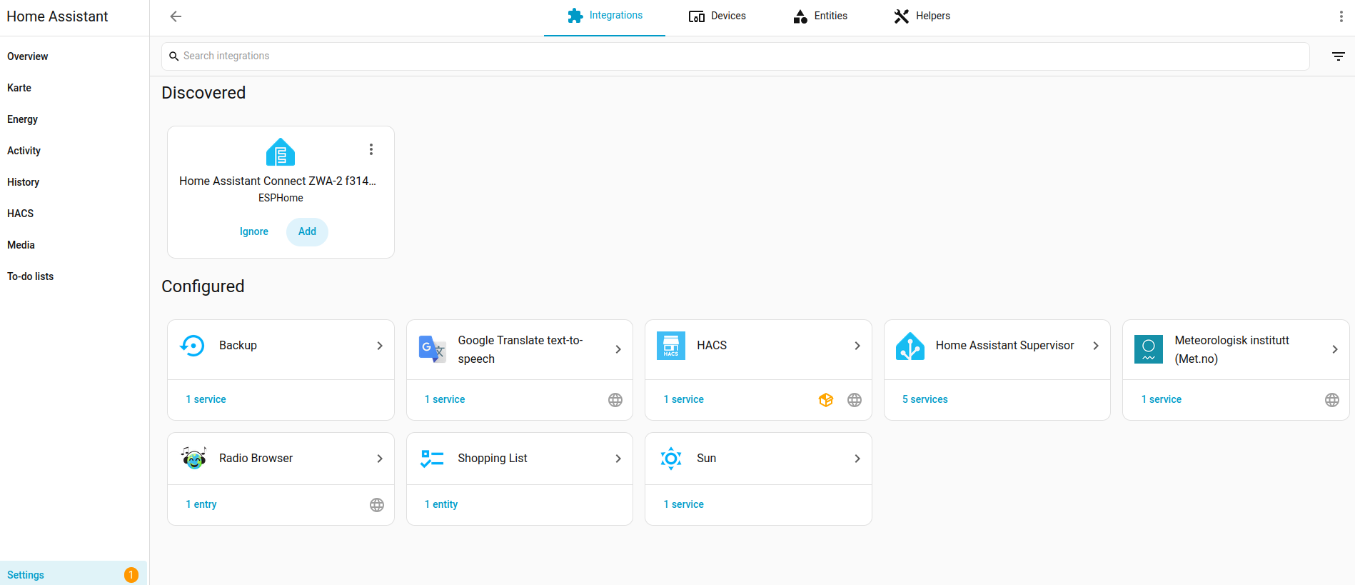

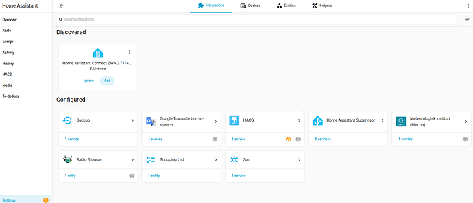

I still can’t get the ZWA-2 wit ESP running. I want to describe my process of integration in detail:
HA discovered the ESPHome.
I click on Add, assign Device name and Area.
Then I get this page:
According to the guide, I should then search for detected Z-Wave devices on the same page (=Integrations).
There I can only find a new Bluetooth device.

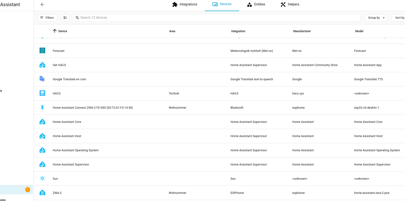

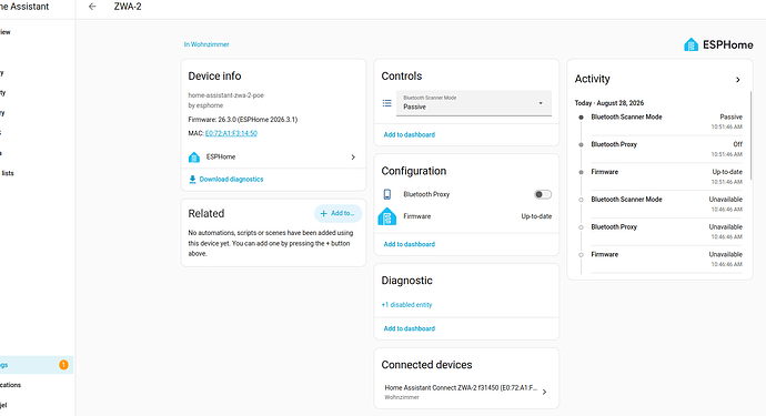

The devices page shows these devices:

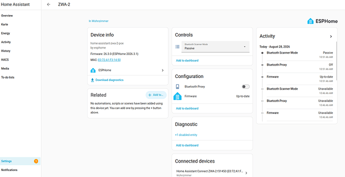

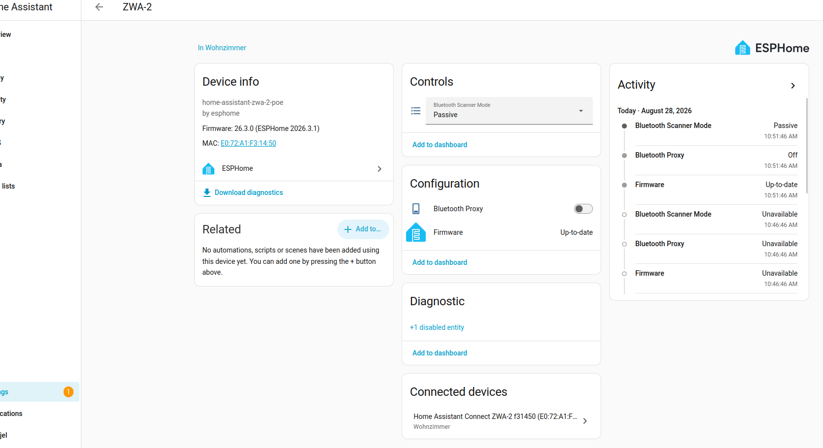

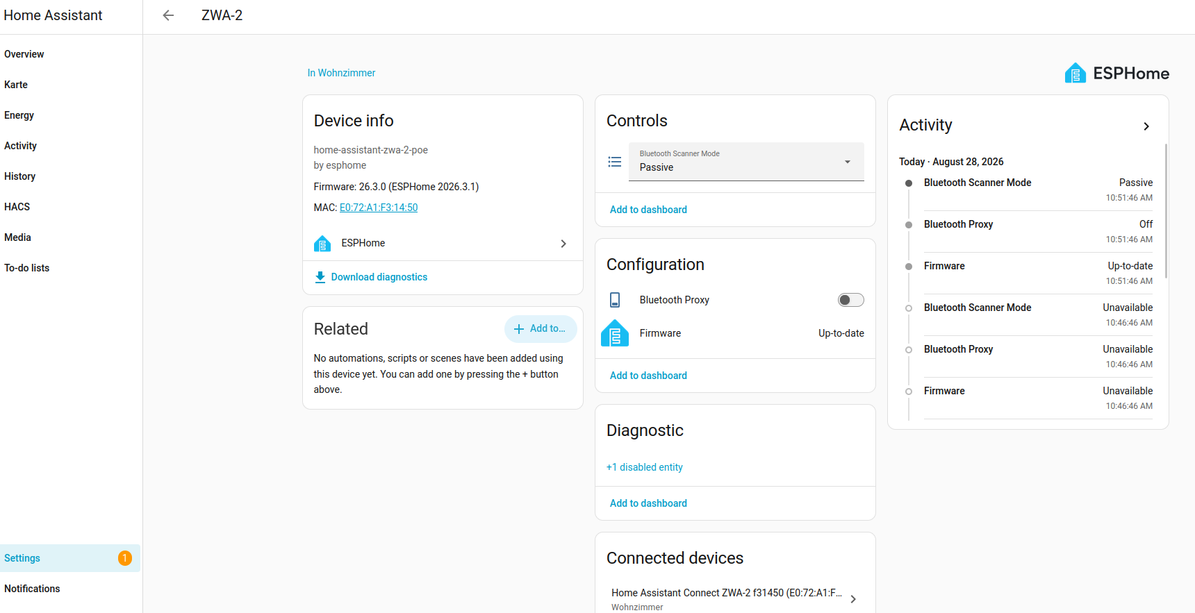

A new Bluetooth device is shown and th ZWA-2 device. I open the “ZWA-2” device page:
What is this Bluetooth device? The ESP or the ZWA-2?
No new Z-Wave device discovered :frowning:
