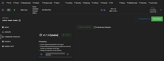

sorry i wasn’t clear. I did the upgrade from here (inside zwave-js-ui):
Do you have some kind of firewall rules that are blocking access to the Z-Wave JS firmware upgrade service?
If you are continuing to have trouble, you could try the ZWA-2 Toolbox. Just plug the ZWA-2 into a PC that has the Chrome browser, and open that link with Chrome. It can upgrade the firmware for you.
Thanks for the extra info! Really weird that it doesn’t show up for me, I don’t even get the ‘No updates available’ response, it just shows a loading spinner for me with the text “Remember to wake up sleeping devices…”. Already turned on DEBUG logging but it doesn’t show anything related to this. @freshcoast thanks for the suggestion, I doublechecked but the container that it’s running in has full network access so that shouldn’t be an issue. I’ll have to troubleshoot some more to figure this out. Thanks for the replies!

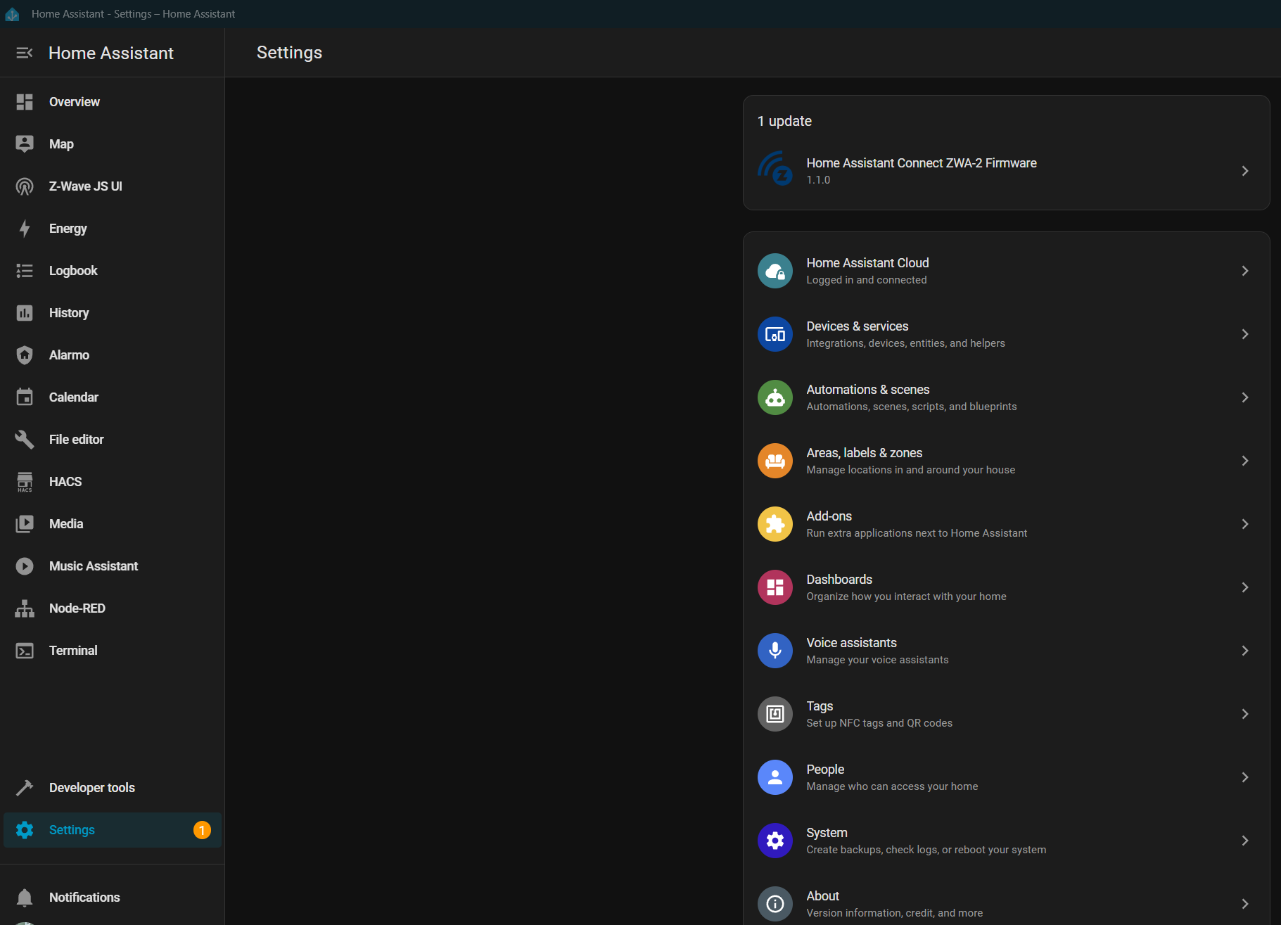

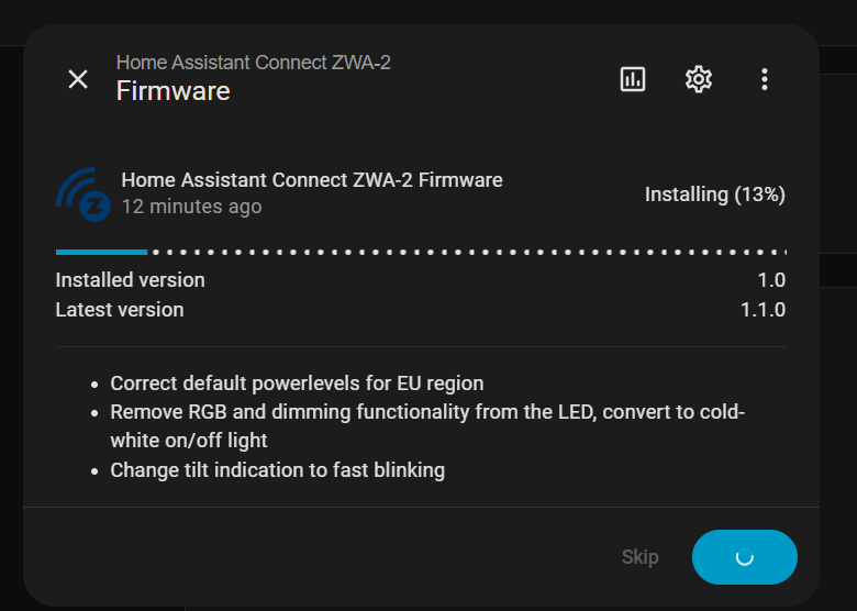

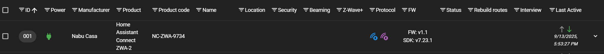

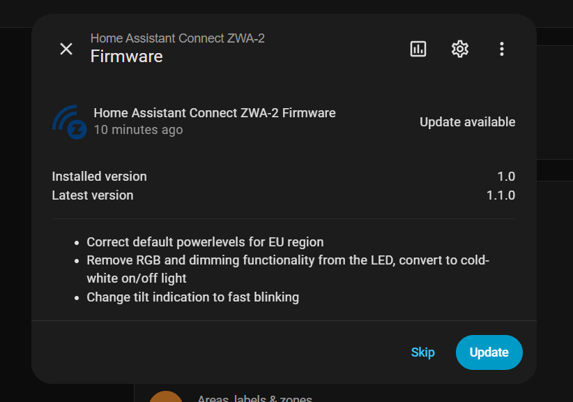

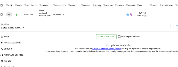

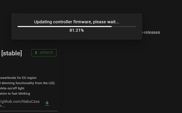

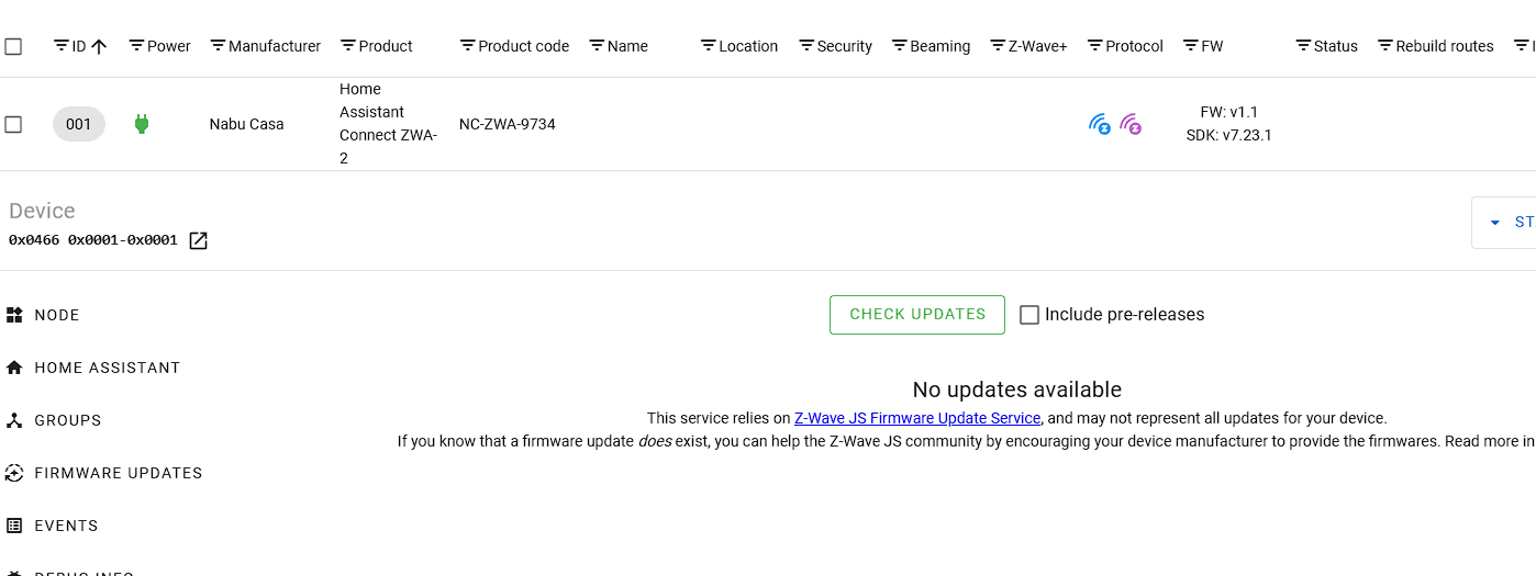

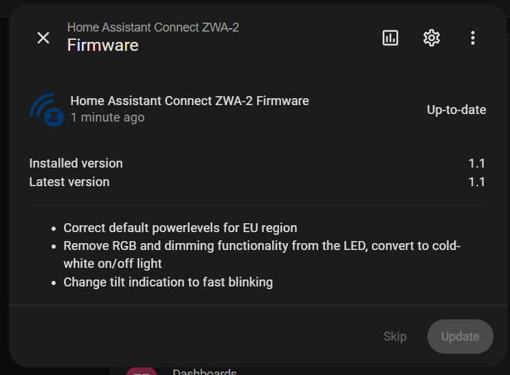

Just replaced my Zooz ZST39LR with the ZWA-2 today running Zwave JS UI on a separate VM from home assistant and it was flawless. This is how the firmware upgrade shows up for me both in ZWave JS UI and Home Assistant. I performed the upgrade from HA and have also included screenshots of the update in progress from HA and ZWJSUI. Final screenshots post update also included. The replacement and the subsequent firmware update were flawless.
