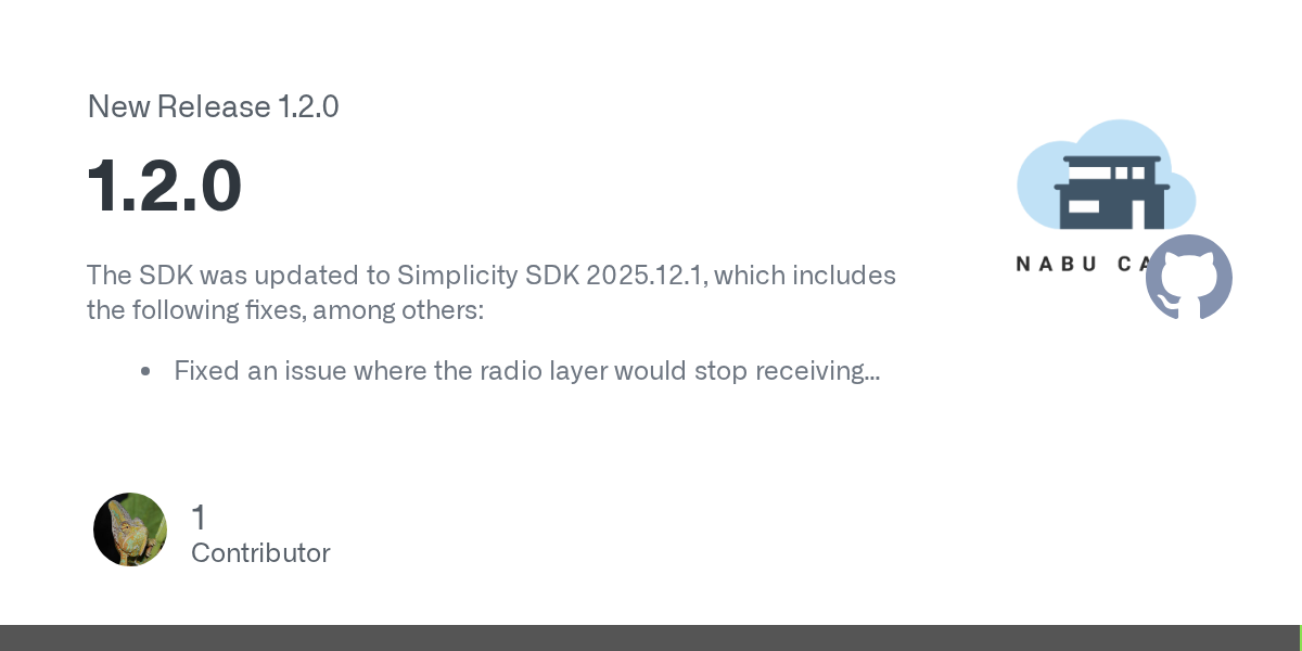

There’s now a beta release for new firmware if you want to test it: Release 1.2.0 · NabuCasa/zwave-firmware · GitHub
If you use Z-Wave JS UI (which includes v1.0.0 of the Core Z-Wave JS app), go to the firmware updates tab under your controller and enable the “include pre-releases” checkbox.
There is an interesting bug:
  • Fixed an issue where the radio layer would stop receiving packet until the next TX radio event
