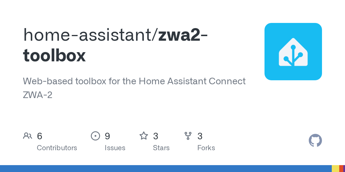

Is there a place I can put in an “official” bug report or something?
I’m not sure if the following is the correct place or not, but it would be a start:

Posted the issue on Github.

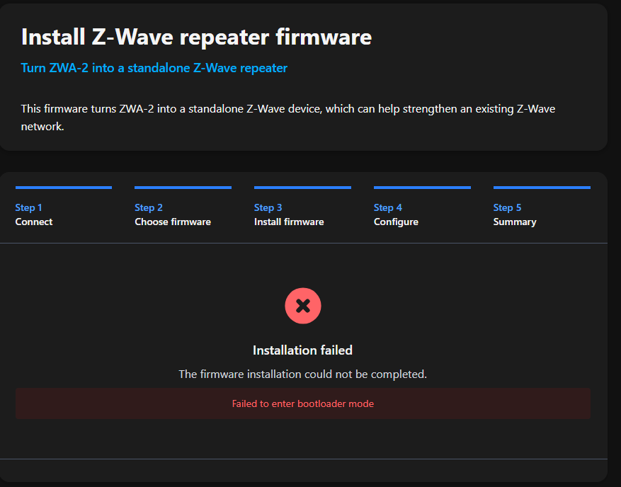

I tried again, and initially installed the bridge firmware, then tried the repeater firmware again and got this error:

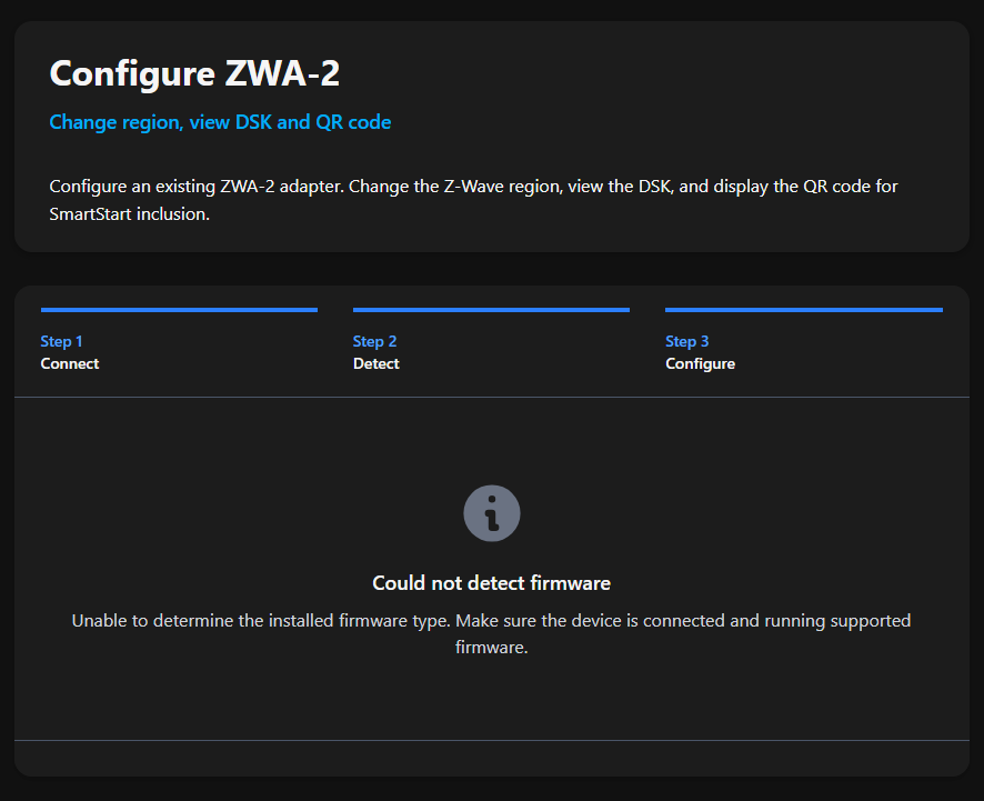

I was able to install the Original USB bridge firmware, but trying to Configure the ZWA-2 shows this error:
I successfully used the Restore Bootloader Keys and flash it to the default USB firmware, but it’s back in the same state as before, where I cannot flash it with the repeater firmware.
I am getting the same “failed to enter bootloader mode” error.

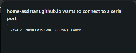

Although it does show up on on the COM list:
Still cannot flash the repeater firmware, even after fixing bootloader keys and successfully installing the controller firmware.

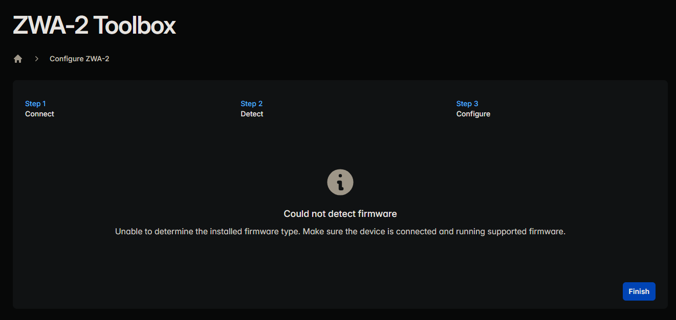

Adding another post here. Now it won’t even recognize the standard USB bridge firmware:
