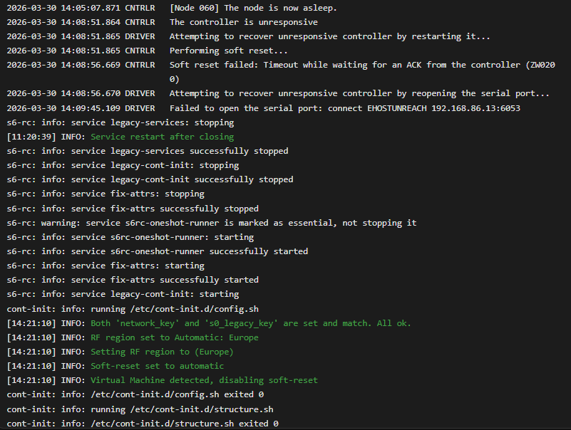

Here we go again. Updated my Unifi Switch and the result to ZWA2 was:
Had to start zwave js again and problem solved. How come zwave js cannot handle network disconnection and reconnection correctly with zwa2?
