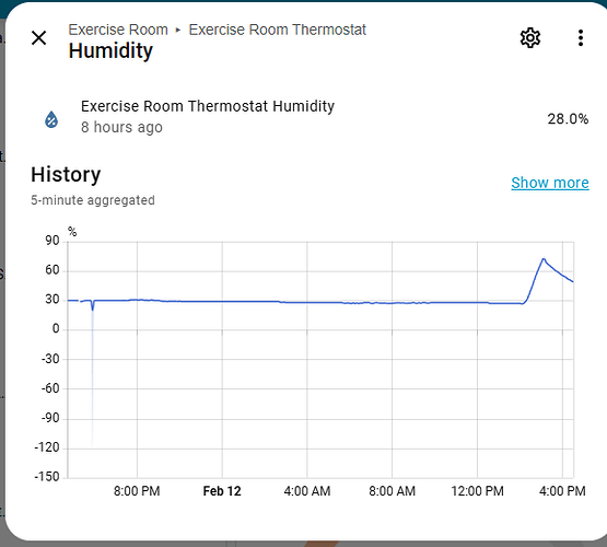

But it sort of half works. All the dashboards are wrong but when I look into the stats history that’s correct. Also, if I change the thermostat temp it doesn’t show on the thermostat card but it does actually make the change at the thermostat (and the stats history shows it). If I look at the Activity pane for the thermostat ZWave device in ZWave, there are no new entries showing up. If I go to the overall Activities (formerly Log) and filter by the thermostat I see all the times the thermostat turned the heat on and off over the last day.

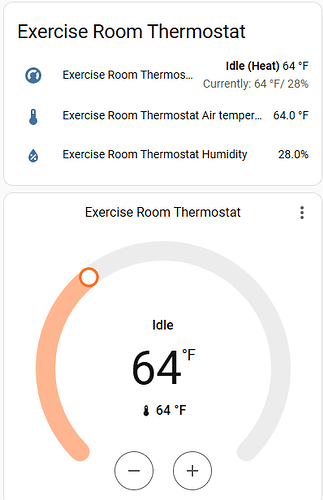

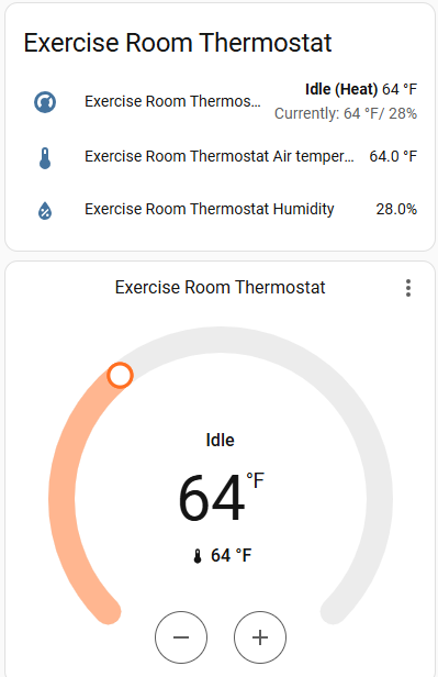

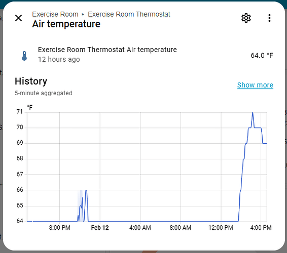

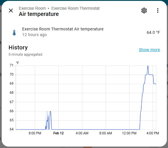

So it’s sort of half broken. This is my overall card. Note that it has current heat and humidity at the top. If I click on one of those I get the stats history.

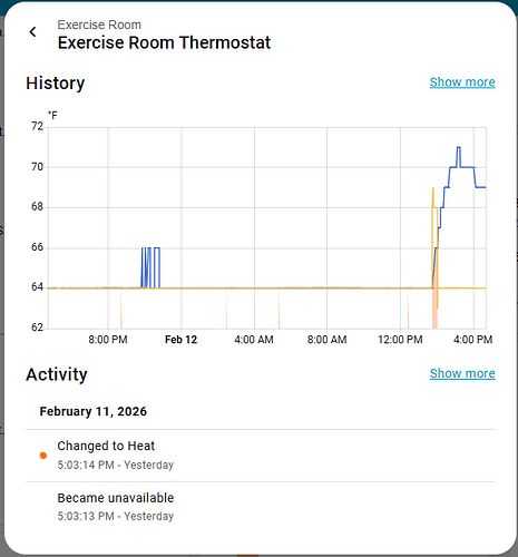

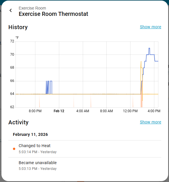

If I click on the thermostat card itself and then look at the details I see this

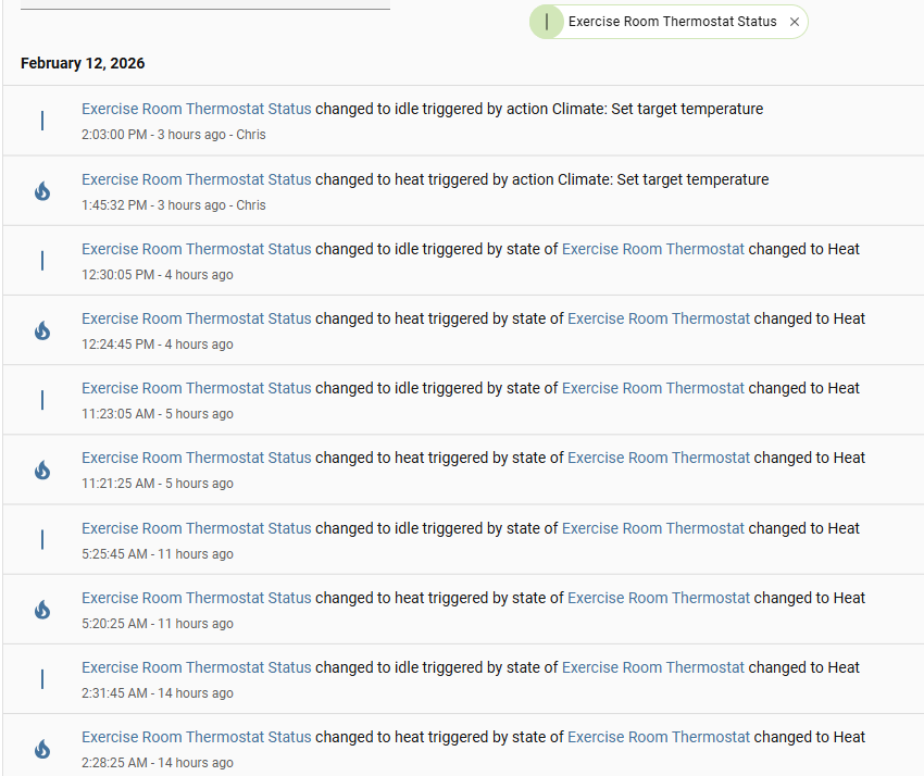

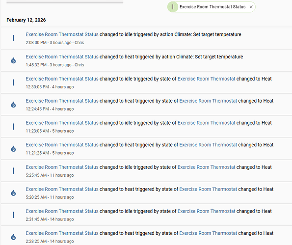

Note the sparse Activity. That’s the same Activity you’d see in the ZWave device page. But if I go to Activities and filter, I get this
I suspect some sort of a disconnect on IDs under all of this but I don’t know how to inspect them, let alone fix them. They don’t show in the UI for the card that I can find.
