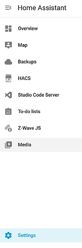

but the left side menu on HA shows ZWave JS:
I do not see ZWave Js anywhere else

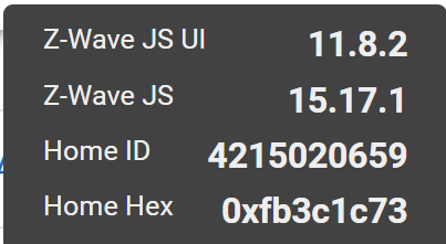

In ZWave JS IU it shows:
zwave-js-ui: 11.8.2
zwave-js: 15.17.1
home id: 4215020659
home hex: 0xfb3c1c73
If I have ZWave JS, how do I remove it ?

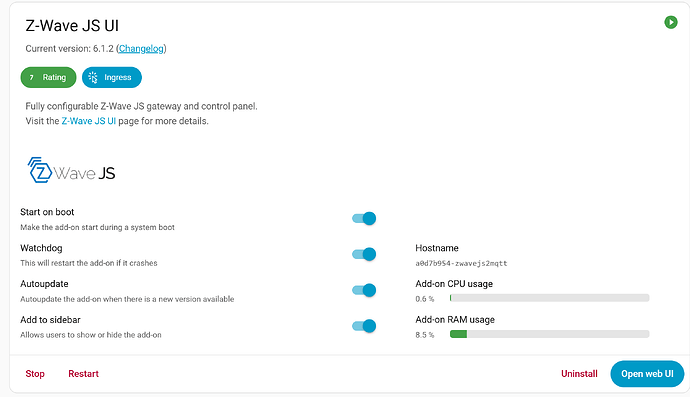

I am not sure about this. While ZWave JS appears in my Sidebar, it does NOT appear in my Add-Ons. Only ZWave JS UI shows in my add-ons. Furthermore in the configuration of the ZWave Integration it appears that I am using ZWave JS UI. So the question (and my mystery) is why it shows ZWave JS in the Sidebar ?
Because that’s the panel the Z-Wave JS UI add-on installs. There is not a UI for Z-Wave JS core add-on.
Thanks. As I posted just now, the ZWave configuration shows that I am using ZWvae JS UI, but I wonder why it shows ZWave JS in the Sidebar and a very similar but different page opens when clicking on ZWave JS in the Sidebar and the info is:
There is NO ZWave JS in the Add-Ons, only ZWave JS UI
