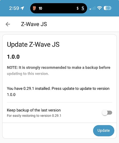

With the zwave js 1.0.0 notification zwave js ui, is there no longer a separate zwave js upgrade? Overwhelmed by all the changes. I just started a month ago with HA Green. I want a basic zwave solution for lights, plugs and thermostats. I don’t want anything to break.

Apps (previously add-ons) are always separate upgrades from HA Core. Z-Wave itself is still provided by the app, and integrated with the Z-Wave integration, this isn’t changing.
