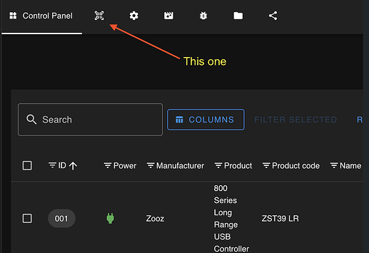

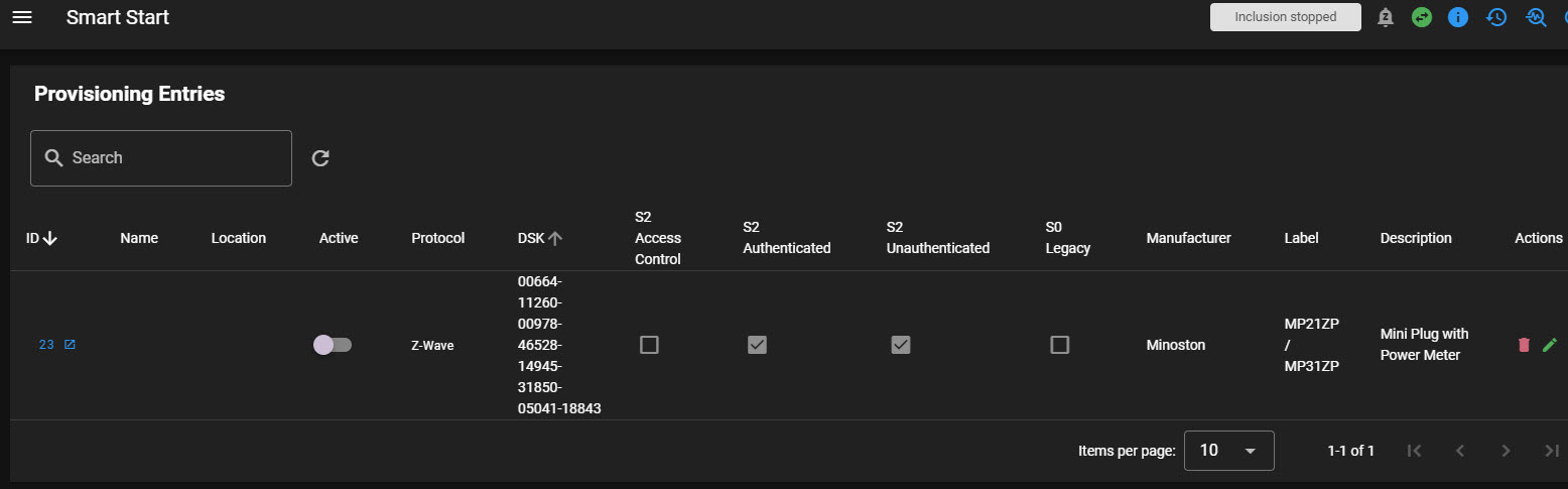

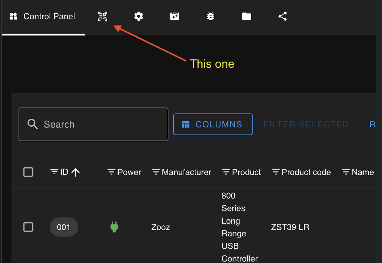

When you open ZUI you can click on the SmartStart button:

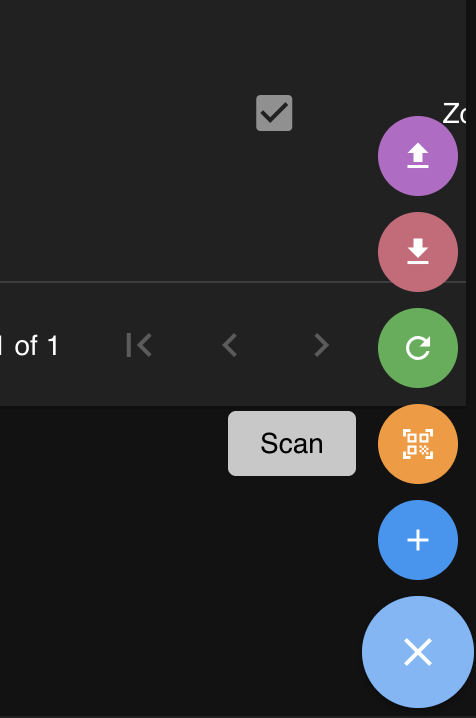

Then on the SmartStart screen you click on the button in lower left to open this menu and select “Scan”
Here’s where people do different things. You need to scan the QR code and there’s different ways to do that. I have a Mac so I can just paste, so quite easy. But you could text or email it or whatever.

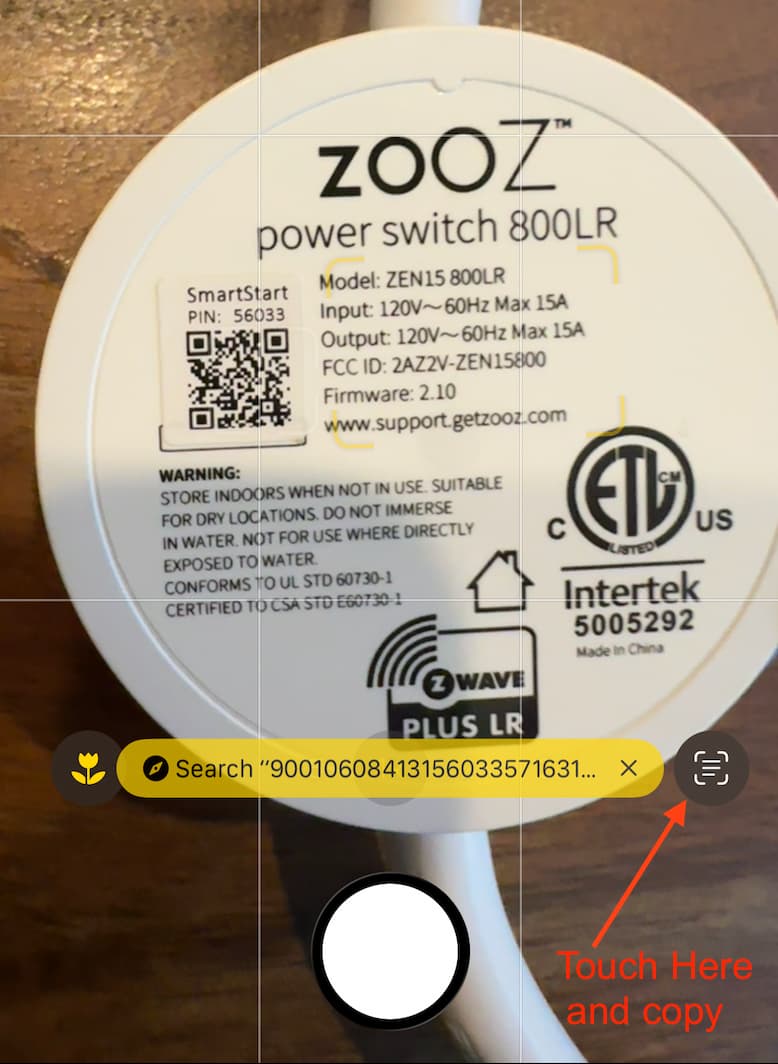

You can only scan from your computer if running with SSL (https://), so what I do is use my iPhone like this:

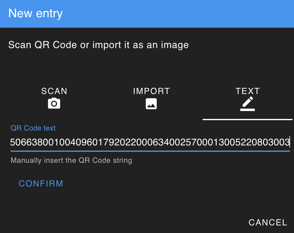

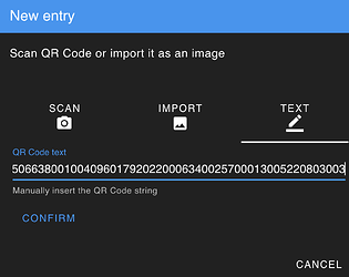

And then in that “Scan” dialog from the previous step paste it in the “Text” method:

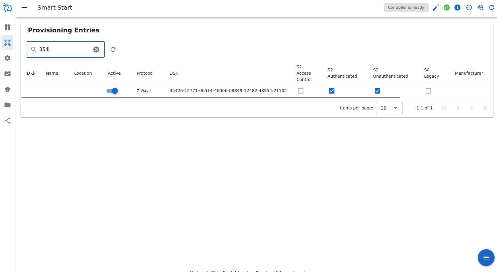

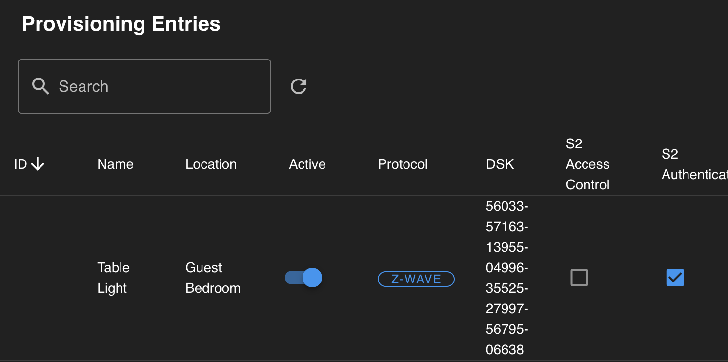

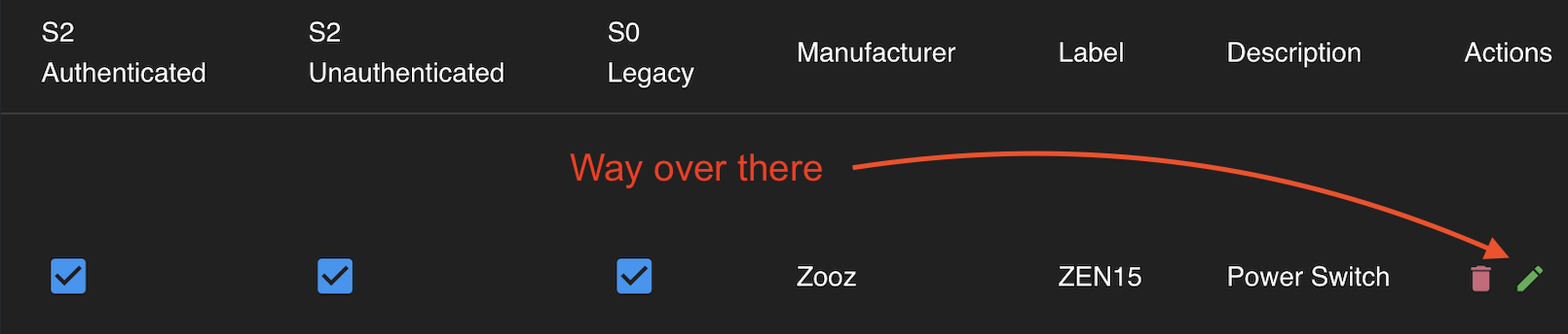

and click CONFIRM. You should see a new entry where it already knows the make and model of the device. Then you have to scroll all the way to the right to find the edit button:

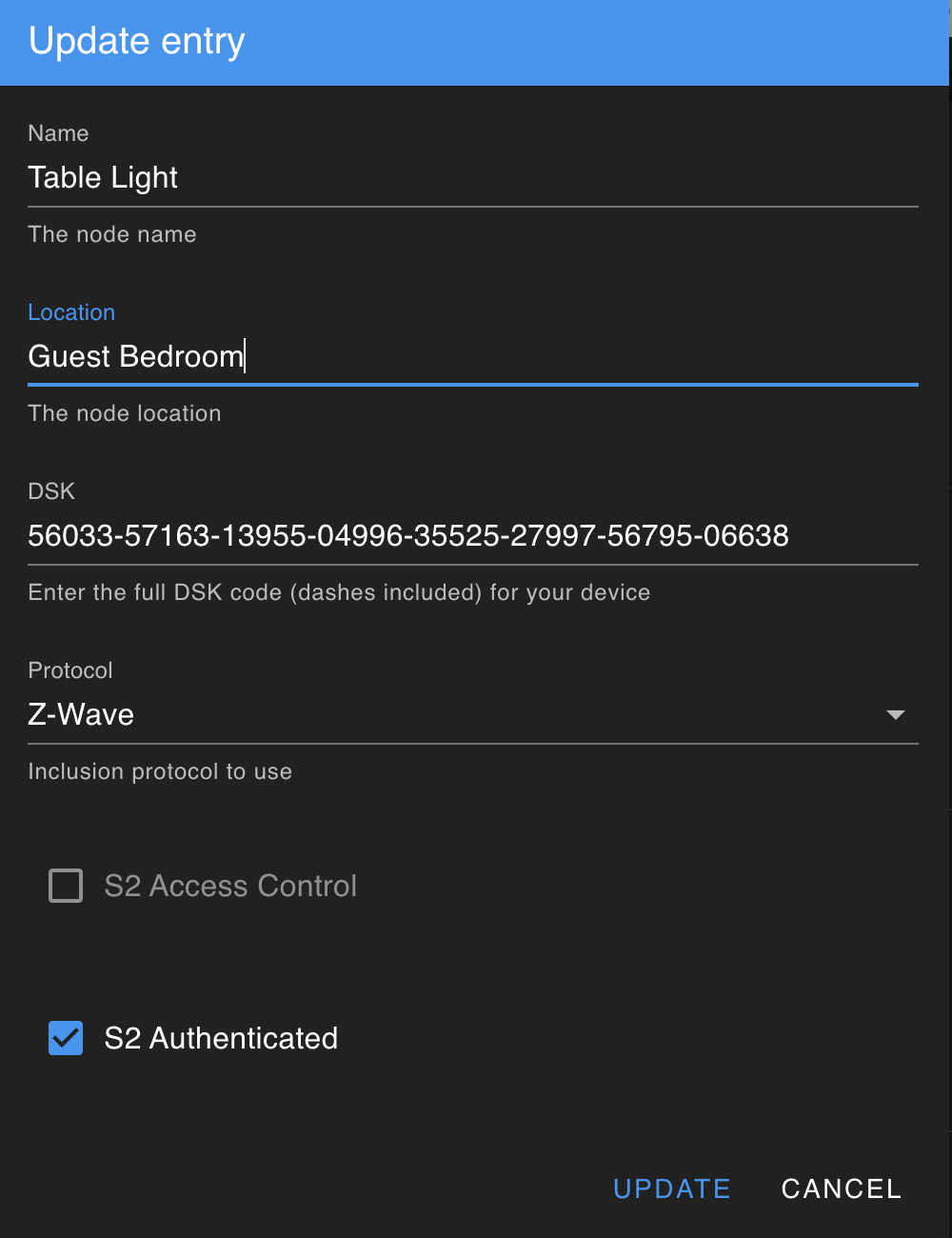

Click on that and fill in the name and location and click UPDATE.

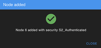

Then the last step is turn on the Active switch:

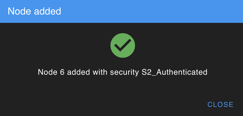

Now all you do is plug in the device and wait a few seconds and this will show up:
That’s it. If you ever remove (exclude) that device the SmartStart data is still available and if enabled all you do is plug in the device again and it will connect.

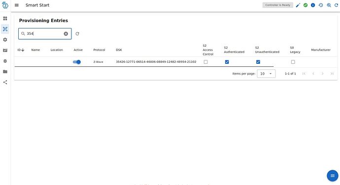

I already have a bunch added without doing that so can I do this after the fact of having them added already? This is the only one that was lucky.
Yes, you can go into the “Control Panel” page of the ZUI where all your “already” included devices are at, and for a given device entry, click on it and it exposes a place where you can enter the name/location.

I think @Paddy707 was asking about adding devices already included into the provisioning list for a later re-include.
Handy to have all the devices in the provisioning list so if a controller failed or you somehow needed to re-include devices you wouldn’t have to go find QR codes.

Yes, you can scan or enter the DSK w/o re-including. When you do that you will probably see it show the current node ID on the left of the provisioning page.
The QR code has the DSK and additional info.
If curious, here’s one of my QR codes you can past in here and see how it decodes:
9001376161313585964349240931510364168279215678332505001004096017920220006340025700013005220803003
You can add devices either useing the DSK or QR, I think. I just always use the QR since it’s easy with my phone. And then I just plug in the device and that’s it.
I posted above with screenshots on how I do it. I’m sure there’s other ways.

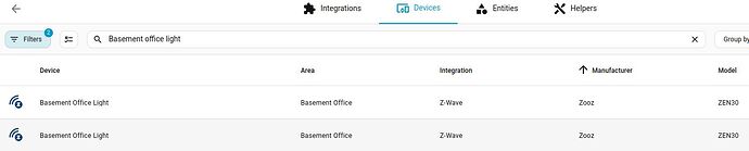

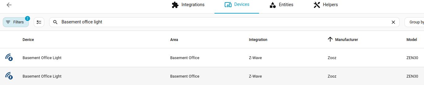

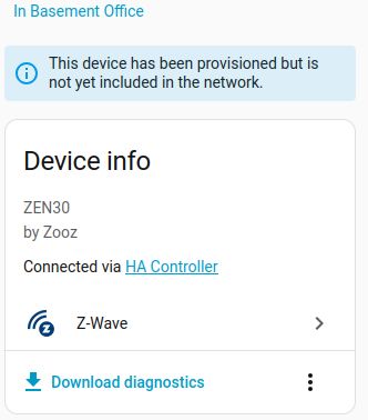

Hrm. Yeah. That’s not what I get. They all show up like this photo. And under the zwave entries they all show up as new devices in “not ready” state. :weary: :man_shrugging:
Notice it makes duplicates instead of merging:
If you click on Z-Wave on that last image (device page) for each does it show differ node IDs?
And dos ZUI show multiple or duplicates?
Z-Wave JS can’t associate the provisioning entry with an existing node if the DSK does not have a match. You mentioned in your other post missing DSKs.
If you add the QR code in HA it will create the pending device until the node is added. Adding the QR code in Z-Wave JS UI will not create the pending device.
Yes.
I do not see multiple/duplicates. Just the original.

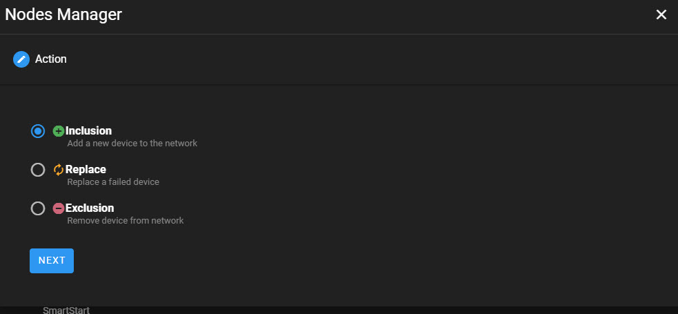

Ah. Interesting. If I use the Z-Wave JS to scan the QR code :- it crashes the app. But if I use the “add device entry” I can scan the QR code. Let me try manually adding the QR code to the Z-Wave JS and see what happens.
Thanks!
Hrm. No different capturing the QR and adding it via text except for the toggle option between mesh and LR. It did not associate with the existing ID. :frowning:
How you add the QR code won’t have any influence in how an included node is associated with the provisioning entry. Did you confirm the DSK is known for this particular device? See:
