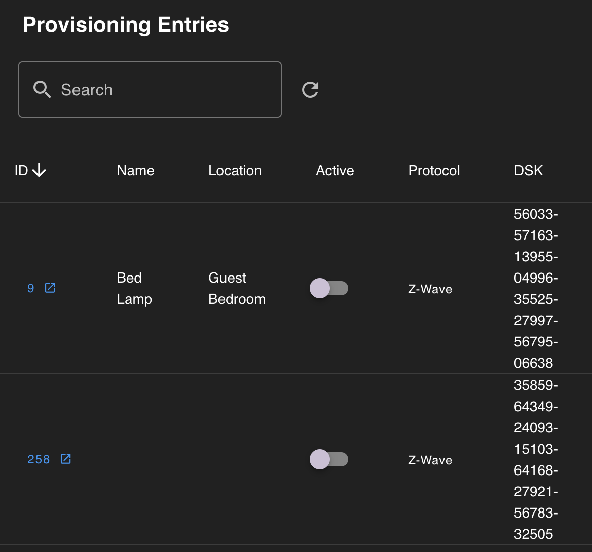

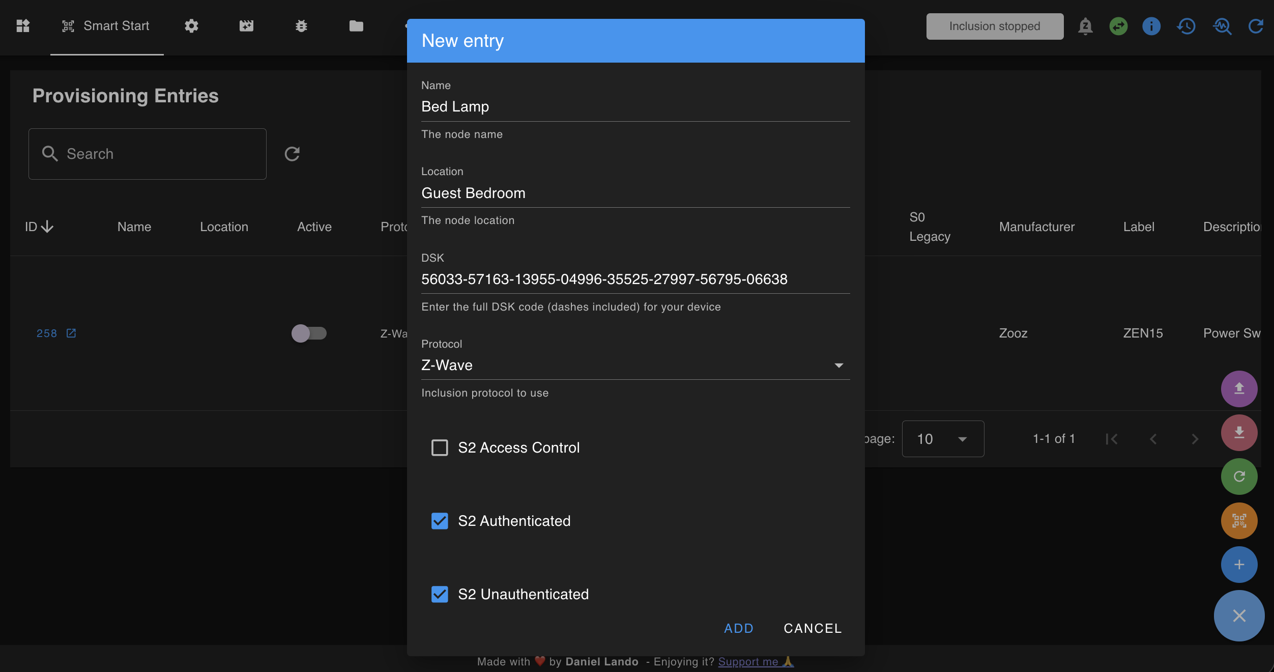

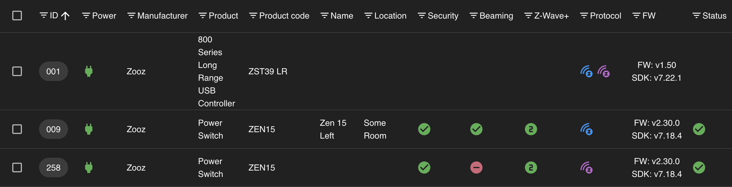

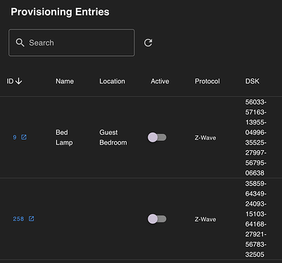

Again, they don’t really go into HA. You would add them to the Z-Wave JS provisioning table. You can do that via HA, but then HA creates (what seems to be) a placeholder device. You don’t want a new device because the devices are already included.
That’s why I prefer to use the ZUI Provisioning screen. Did you try that?

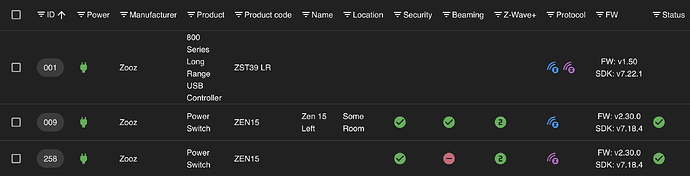

Here you can see that “Zen 15 Left” is already include as node 009:
It does not have a provisioning entry, so I add it like this:
(although I always use the QR code, not the DSK)
And after I click “ADD” it adds it to the Provisioning Entries and you can see the UI now shows it associated with the existing Node 9.
Again, one big value, other than backup, to add the devices to the SmartStart/ (Provisioning Entries) page is so if you exclude a device and then include it again it should keep the same entity IDs – meaning your automations, dashboards, etc. won’t need updating.
