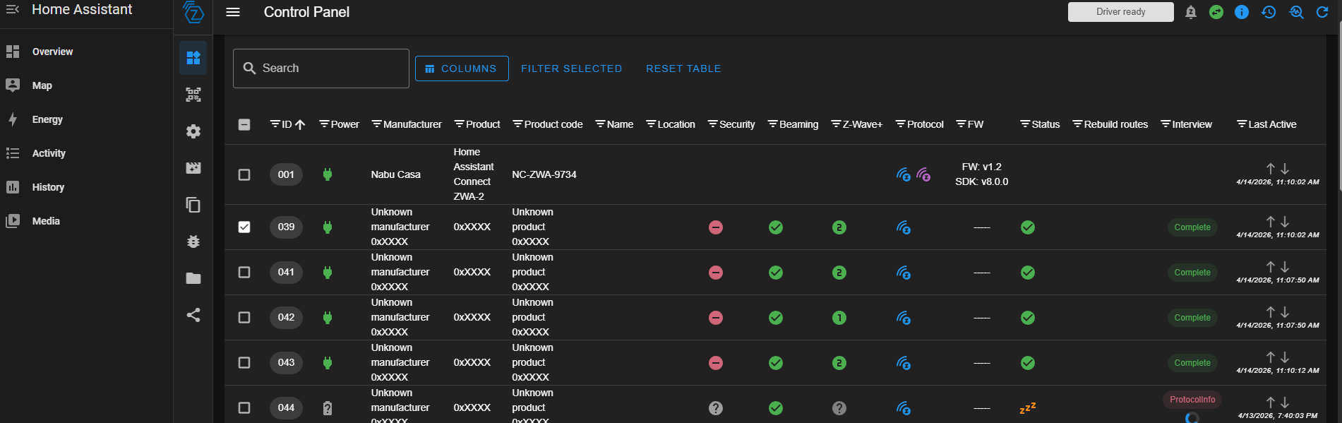

I noticed in a recent update that Zwave JS UI is now included with the base Zwave JS app. However I was running Zwave JS UI already before. I’ve stopped and uninstalled the old ZWave JS UI app but in the new Zwave JS that includes the UI, all of my devices show as unknown attributes. Like this:
As well, the devices are not functioning in the dashboard. I can ping them though in the new Zwave JS ui. I tried to do a re-interview node, and refresh values but still doesn’t seem to be listing them correctly.

You cannot simply remove zwavejs-ui and directly replace this with zwavejs.
See on this page Z-Wave - Home Assistant , paragraph “Migrating from Z-Wave JS UI to the Z-Wave JS app“ how to migrate to the new app.
