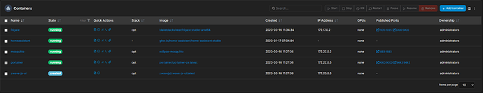

Yes, tried this earlier, too. Forgot that I got this:
COMMAND PID USER FD TYPE DEVICE SIZE/OFF NODE NAME
node 1286 root 19u IPv4 18186 0t0 TCP localhost:8091 (LISTEN)
I couldn’t figure out what that went to, got distracted, and forgot about it…
So this is interesting:
UID PID PPID C STIME TTY TIME CMD
root 1286 650 0 11:44 ? 00:00:02 /snap/zwave-js-ui/136/bin/no
Yet my portainer shows it’s not running and no IP – EDIT: it’s showing an IP. It wasn’t earlier. I’m not able to access the web interface from the FTP.
Okay gents, this is weird…I can access it from http://localhost:8091. So what the heck is going on? Nothing is configured in this and it looks different than I remember. What in sam hill??
I unplugged the z-wave adapter and restarted…no change.
I commented out the whole z-wave section of my docker compose and ran docker compose -d --remove-orphans and it showed it was removed…and I can still access via localhost:8091. So…where the heck is this thing launching from???
Yes, interesting. I was able to stop the snap service and then spin up my container and now container isn’t erroring out.
However, how the heck did the snap get installed and how do I get rid of it. I tried to disable it and it says it’s not installed.
