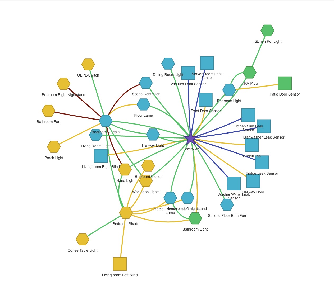

@memphi2 Forgot to tag you in the reply. Graph looks normal to me?
It does not look really bad, but it’s far away from perfect. You have some single points of failiure(Bedroom Shade and Curtain), some slow routes and routes with unnecessary hops. Let me guess, eg. Porch Light is delayed.
Try to rebuild routes of the delayed nodes, or set the routes manually, so I did.

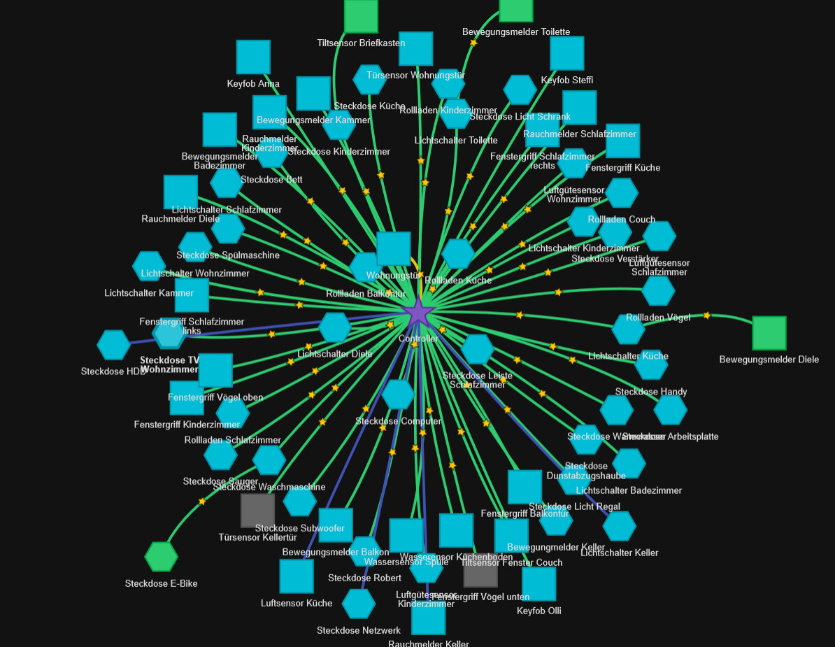

The graph of one of my networks, no delays at all…
Oh, forgot to mention…currently it is NOT possible the set a direct route from the conroller to a node manually. There is a bug in SDK 7.23. So I did that using an ZAC93 with an older SDK and exported the NVM.

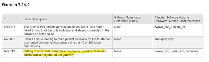

I think we have to wait for a new firmware with SDK 7.24.2 to have this issue fixed:
